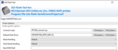

When I tried to debug after selecting the "link application to RAM" option I was able to debug and I am transmitting something(some dots and not the correct data).
But I can't program when "Link application to RAM" is selected.
This is what I get.
Connected: was_reset=false. was_stopped=true
( 70) License Check Complete
File 'SerialCommProject.axf' load failure: Ef(11). No flash configured.
(100) Target Connection Failed
Unable to perform operation!
Command failed with exit code 1
I also had to change the size of the Flash in order to debug the code in main(), this is what I have set, I don't know if it's correct.
What should be the boot mode set to? where can I check it?

I tried using J-link debugger, I am getting same result.
I confirmed the board I am using has QSPI chip, so "MIMXRT1060_SFDP_QSPI.cfx" is set correct.
