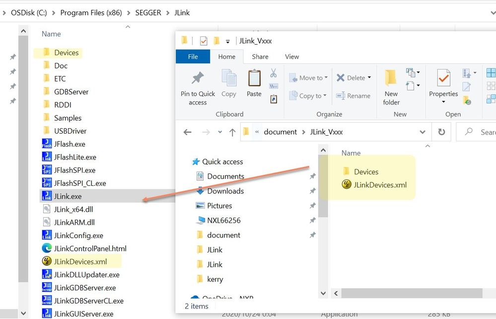

   Now, to the RT600 QSPI, give the related flash algo file patch.
   Copy the following path file:
\RT-UFL-1.0\algo\SEGGER\JLink_Vxxx
To the JLINK install path:
\SEGGER\JLink
Then copy the content in file:
RT-UFL-master\test\SEGGER\JLink_Vxxx\Devices\NXP\iMXRT6xx\archive2\evkmimxrt685.JLinkScript
To replace the content in:
C:\Program Files\SEGGER\JLink\Devices\NXP\iMXRT_UFL\iMXRT6xx_CortexM33.JLinkScript

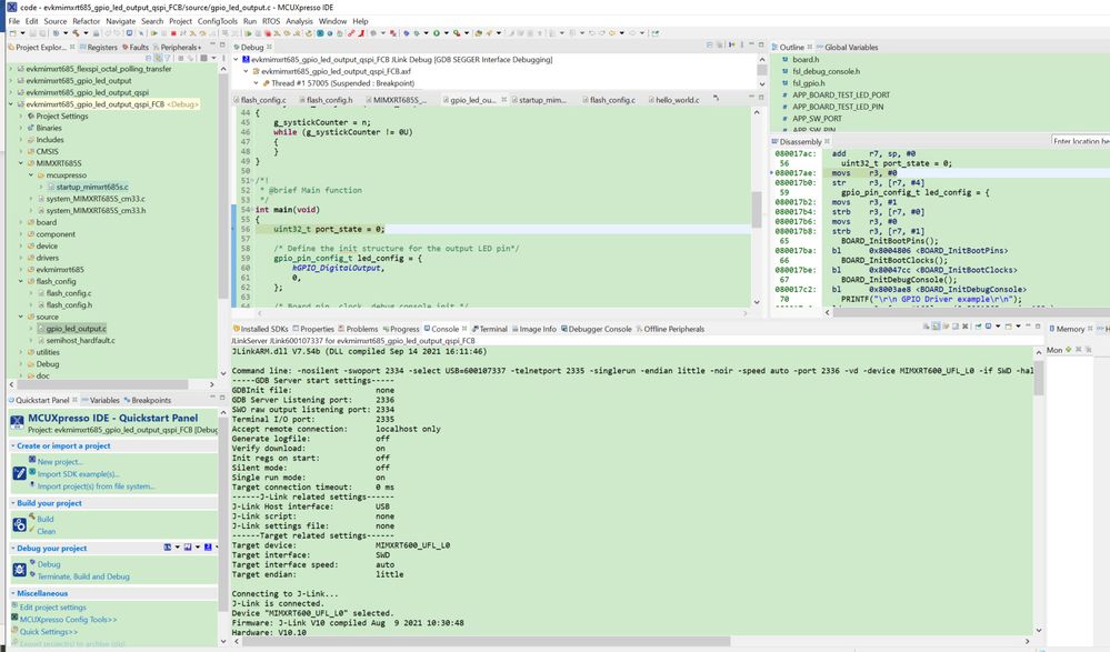

Otherwise, the MCUXpresso IDE debug reset button function will not work. So, need to add the JLINKScript code for ResetTarget, which will reset the external flash.
pic1
The RT-UFL provide 3 types download flash algo: MIMXRT600_UFL_L0, MIMXRT600_UFL_L1, MIMXRT600_UFL_L2.
Pic 2

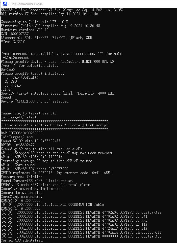

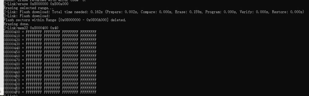

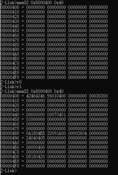

2.3 JLINK commander test
Please note, the device need to select as MIMXRT600_UFL_L0 when using the QSPI flash.
Pic 3
pic 4
Pic 5
We can find, the JLINK command can realize the external QSPI flash read, erase function.

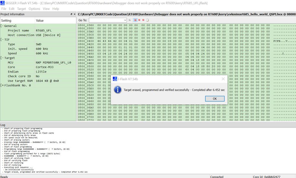

2.4 Jflash Test
Operation steps: Target->connect->production programming
Pic 6
We can find, the Jflash also can realize the RT600 external QSPI flash erase and program.
Please note, not all the JLINK can support JFLASH, this document is using Segger JLINK plus.

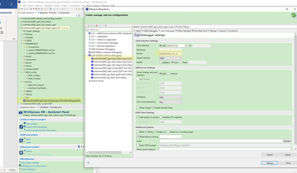

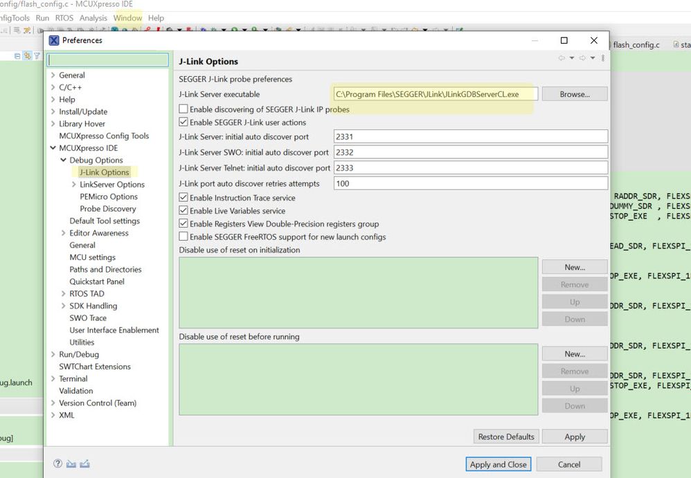

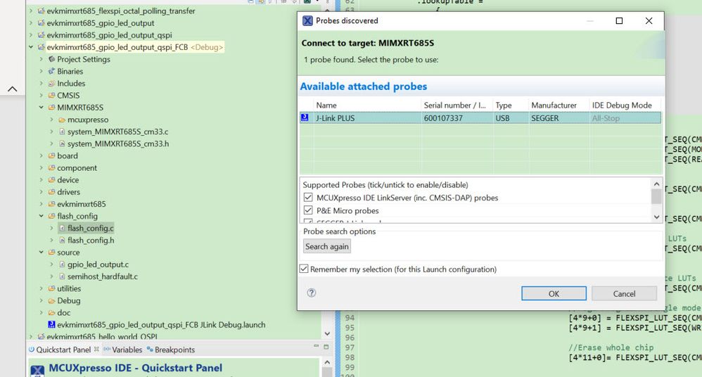

3.2 Debug configuration
Configure the JLINK options in the MCUXpresso IDE as the JLINK driver: JLinkGDBServerCL.exe
Windows->preferences
Pic 7
Press debug, generate .launch file.
Pic 8
Pic 9
Choose the device as MIMXRT600_UFL_L0, if the SWD wire is long and not stable, also can define the speed as the fixed low frequency.

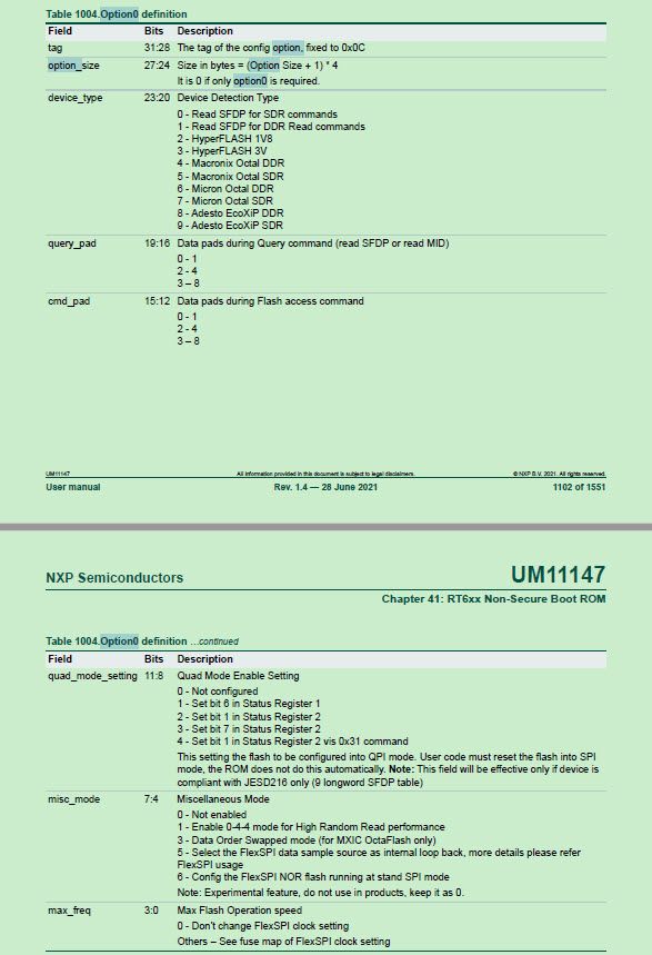

4.1 SDK IAP flash code test
We can use the SDK related code to test the external flash operation or not at first, the SDK code path is:
SDK_2_10_0_EVK-MIMXRT685\boards\evkmimxrt685\driver_examples\iap\iap_flash

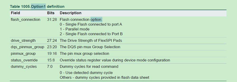

Then, check the external flash, and modify the code’s related option0, option1 to match the external flash. About the option 0 and option1 definition, we can find it from the RT600 user manual Table 1004.Option0 definition and Table 1005.Option1 definition
Pic 11
Pic 12
To the external QSPI flash which is connected to the FLexSPI portA, we can modify the option to the following code:
    option.option0.U = 0xC0000001;//EXAMPLE_NOR_FLASH;
    option.option1.U = 0x00000000;//EXAMPLE_NOR_FLASH_OPTION1;

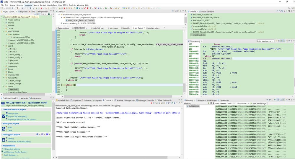

Then burn the IAP_flash project to the RT685 internal RAM, debug to run it.
Pic 13
We can find, the external QSPI flash initialization, erase, read and write all works, and the memory also can find the correct data.

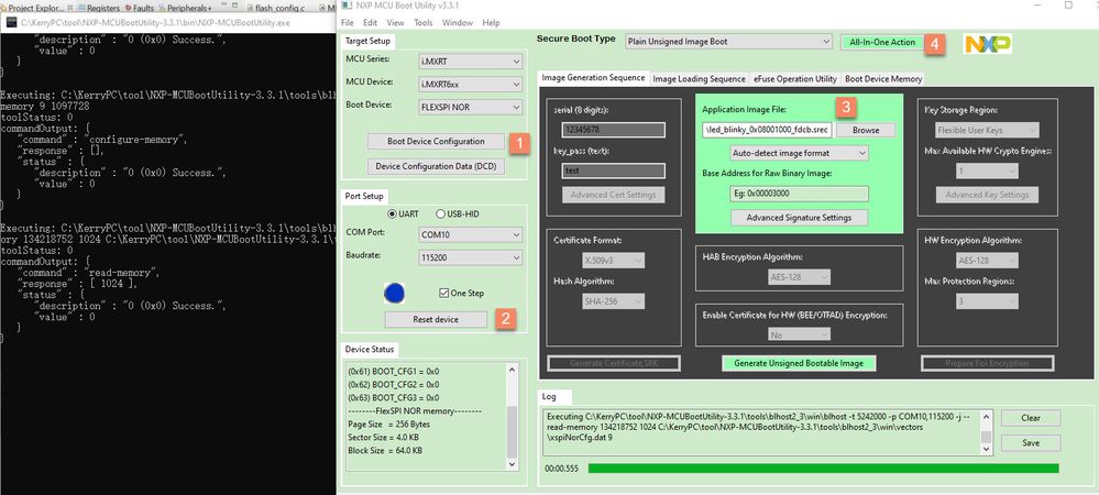

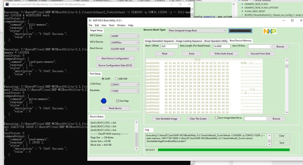

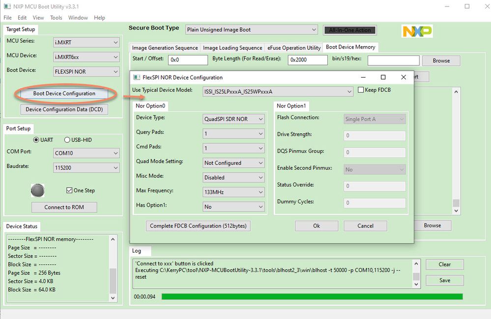

4.2 MCUBootUtility test
  Chip enter the ISP mode, then use the MCUBootUtility tool to connect the RT685 and QSPI flash, to do the application code program and read test.
ISP mode:ISP2:high, ISP1: high ISP0 low
Configure FlexSPI NOR Device Configuration as QSPI, we can use the template: ISSI_IS25LPxxxA_IS25WPxxxA.
Pic 14
Click connect to ROM button, check whether it can recognize the external flash:
Pic 15
After connection, we can use the tool attached RT685 image to download:
NXP-MCUBootUtility-3.3.1\apps\NXP_MIMXRT685-EVK_Rev.E\led_blinky_0x08001000_fdcb.srec
Pic 16
We can find, the connection, erase, program and read are all work, it also indicates the RT685+external QSPI flash is working. Then can go to debug it with IDE and debugger.
