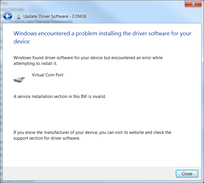

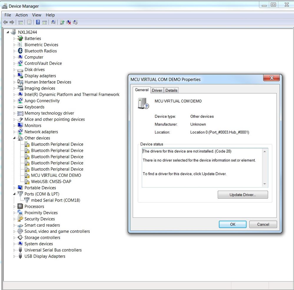

I want to have the input serial port console by plugging a second micro usb cable to EVT J9 connector link to my PC, but it's not working
When I plug cable, the usb driver doesn't instally correctly and in the Device manager I can see MCU VIRTUAL COM DEMO
So I try to reinstall manually usb driver found in SDK: ~\boards\evkmimxrt1060\usb_examples\usb_device_cdc_vcom\inf
but get following error:
and device never appears in COM ports of my computer

Hi Bruno Lemesle
In the first image, could you select the Driver tab? this demo uses the Usbser.sys driver that is in the windows system:
Also, just to confirm, SDK: ~\boards\evkmimxrt1060\usb_examples\usb_device_cdc_vcom\inf you have unzip the SDK package, correct?
I would try to corroborate that the file works correctly, and if you have issues, look for the USBser driver.
