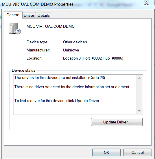

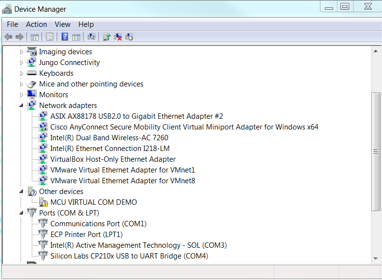

I just build and loaded the shell app found in the MKW2xD_ConnSw_1.0.1 package. The load went fine, BUT when I attempted to find a corresponding COM port, I could not.
Instead, I found MCU VIRTUAL COM DEMO listed under the "Other devices":
When I fetch the properties, I get:
I can find no such suitable driver so far
Help!

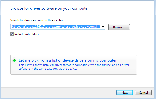

In your MCU Virtual Com properties click in Update Driver... Then click in Browse my computer for driver software

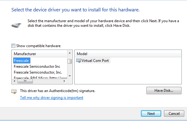

After this click in Let me pick from a list of device drivers on my computer and In manufacturer select Freescale and Model Virtual Com Port. click in next and update drivers.
If this didn't work you, you can use the drivers that are located in the path C:\nxp\MKW2xD_ConnSw_1.0.1\middleware\usb_1.1.0\example\usb_device_cdc_vcom\inf, Just copy the path in the browse for driver software on your computer instead of click in let me pick...
Please try this and tell me how it goes.

georgewicks
Thank you Jorge! That fixed it.
