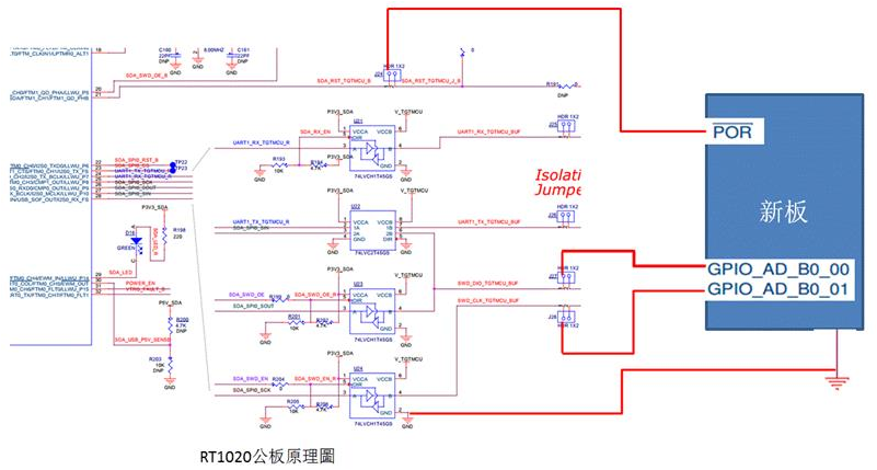

Hi all:

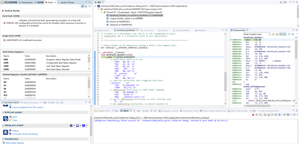

    We got one problem that our EVK board can not execute from SDRAM.
Chip: I.MX RT1020
SDK:  SDK_2.5.0_EVK-MIMXRT1020
example_1(SRAM)evkmimxrt1020_freertos_hello
example_2(SDRAM):evkmimxrt1020_hello_world
All the example used above are the SDK demo examples.
example_1 memory configure:
This example can work well in our EVK board and the MIMXRT1020-EVK too.
example_2 memory configure:
This example still can work well in the MIMXRT1020-EVK ,but goes wrong in our EVK board,and the error show as below picture:
What should we try to fixed this problem? Or is there something goes wrong with our EVK board?
By the way,I want to know one question that can we use the MIMXRT1020-EVK SWD port to debug another board.
just for the normal programming and debugging.
Try as below figure:

2) By the way,I want to know one question that can we use the MIMXRT1020-EVK SWD port to debug another board.
-- Yes, it's Ok, however, it's only available to debug the i. MX RT1020.

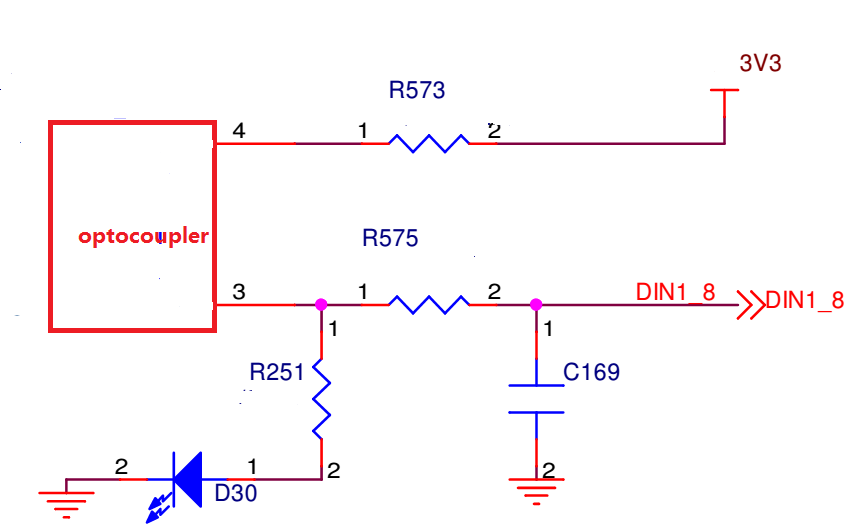

843395729
Hi jeremyzhou:
    Thank you for your reply,for the question 1,we have found the issue, it's cause by one GPIO pin DIN1_8(GPIO_SD_B1_05):
As the picture show above,we set that DIN1_8(GPIO_SD_B1_05) as DIO, the problem seen to be cause by the  capacitance(C169),when we remove it ,our EVK board can work effectively.
we use the same function to the other GPIO,but only GPIO_SD_B1_05 cause that problem,so we doubt that whether the GPIO_SD_B1_05 as one special PIN or not. And then,we try to control it, configure it as output pin,then pull up or down,but it failed.It seen that we can't control that pin.
Is there anyway can sovle this problem?And what is the default status GPIO show when reset device?

jeremyzhou
Hi Software nick ,
Thanks for your reply.
Firstly, GPIO_SD_B1_05 is not very special verses to other pins, the default status of the pin is determined by the SW_PAD_CTL_PAD_GPIO_SD_B1_05 SW PAD Control Register, please check this information in the RM.
Secondly, I was a bit confused with the phenomenon that the issue will disappear after removing the C169, as the GPIO_SD_B1_05 is nothing with the evkmimxrt1020_hello_world demo.
I was wondering if you can introduce the role of GPIO_SD_B1_05 in your board, it can help me to figure the phenomenon out.

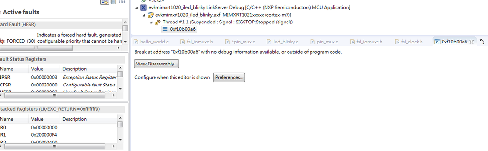

843395729
Hi jeremyzhou:
Glad to receive your reply and thanks for the kind help.
We use that PIN just been a normal GPIO which as one input PIN that can check the external signal.
I guess the picture below will do some help.
We suspect that it was caused by GPIO_SD_B1_05 special using, but nothing deal with that PIN in  evkmimxrt1020_hello_world demo,and then we try to control it as the output GPIO with example evkmimxrt1020_iled_blinky,but another problem comes.(this example testing was did in MIMXRT1020-EVK, that GPIO connect to the 'Combo Sensor'<DNP> on MIMXRT1020-EVK).
the source code show as below:
Pin initial:
void main:
when I try the debug butto and start running, the error show as below picture:
I was wondering whether the PIN configure right,if not,could you show me the right way?

jeremyzhou
Hi Software nick
Does the error (Fig 1) you mentioned above happen when debugging the MIMXRT102? Or debugging your customized board?
If the error happens when debugging the MIMXRT1020 board, I'd like to do some testing to replicate the error.

843395729
Hi Jeremy:
 the error (Fig 1) above  happen was debugged the MIMXRT1020-EVK board.You can try some testing to replicate it.

jeremyzhou
Hi Software nick,
I've replicated the phenomenon on my site, in further, after contact with the AE team, it's related to QSPI Flash Interface, for QSPI Flash as XIP function, to achieve the highest performance it is recommended to left FLEXSPI_A_DQS(GPIO_SD_B1_05)pin floating and config-sample clock source as 01-loopback from DQS pad mode to achieve max 133MHz Flexspi_clk.
During the reset, the boot ROM will configure the GPIO_SD_B1_05 as the FLEXSPI_A_DQS, meanwhile, the RECLKSRC will be configured as 01b too.
When chip startup from BOOT ROM then jump to flash, reconfiguring the GPIO_SD_B1_05 will make the code running become unpredictable, it's the cause of the issue.
Hope this is clear.
