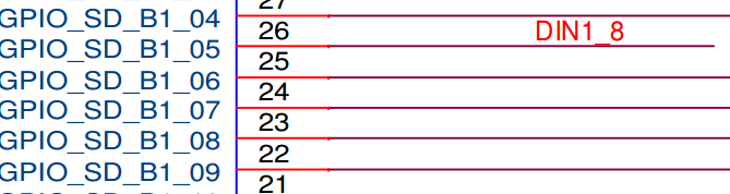

    Thank you for your reply,for the question 1,we have found the issue, it's cause by one GPIO pin DIN1_8(GPIO_SD_B1_05):
As the picture show above,we set that DIN1_8(GPIO_SD_B1_05) as DIO, the problem seen to be cause by the  capacitance(C169),when we remove it ,our EVK board can work effectively.
we use the same function to the other GPIO,but only GPIO_SD_B1_05 cause that problem,so we doubt that whether the GPIO_SD_B1_05 as one special PIN or not. And then,we try to control it, configure it as output pin,then pull up or down,but it failed.It seen that we can't control that pin.
Is there anyway can sovle this problem?And what is the default status GPIO show when reset device?

Firstly, GPIO_SD_B1_05 is not very special verses to other pins, the default status of the pin is determined by the SW_PAD_CTL_PAD_GPIO_SD_B1_05 SW PAD Control Register, please check this information in the RM.
Secondly, I was a bit confused with the phenomenon that the issue will disappear after removing the C169, as the GPIO_SD_B1_05 is nothing with the evkmimxrt1020_hello_world demo.
I was wondering if you can introduce the role of GPIO_SD_B1_05 in your board, it can help me to figure the phenomenon out.
TIC

We use that PIN just been a normal GPIO which as one input PIN that can check the external signal.
I guess the picture below will do some help.
We suspect that it was caused by GPIO_SD_B1_05 special using, but nothing deal with that PIN in  evkmimxrt1020_hello_world demo,and then we try to control it as the output GPIO with example evkmimxrt1020_iled_blinky,but another problem comes.(this example testing was did in MIMXRT1020-EVK, that GPIO connect to the 'Combo Sensor'<DNP> on MIMXRT1020-EVK).

I've replicated the phenomenon on my site, in further, after contact with the AE team, it's related to QSPI Flash Interface, for QSPI Flash as XIP function, to achieve the highest performance it is recommended to left FLEXSPI_A_DQS(GPIO_SD_B1_05)pin floating and config-sample clock source as 01-loopback from DQS pad mode to achieve max 133MHz Flexspi_clk.
During the reset, the boot ROM will configure the GPIO_SD_B1_05 as the FLEXSPI_A_DQS, meanwhile, the RECLKSRC will be configured as 01b too.
When chip startup from BOOT ROM then jump to flash, reconfiguring the GPIO_SD_B1_05 will make the code running become unpredictable, it's the cause of the issue.
Hope this is clear.

1) If we use QSPI Flash for boot purposes we must let pin GPIO_SD_B1_05 as floating and could not use it anymore?
-- If you want to implement XIP mode that runs the code in the QSPI flash, the GPIO_SD_B1_05 should keep floating, however, boot from the QSPI, then run the code in the RAM, you can use this pin for other functions.
