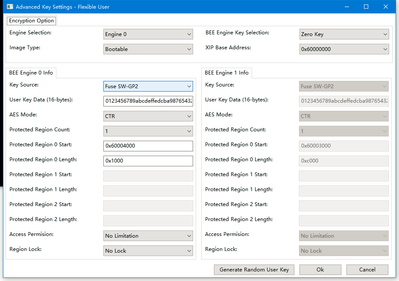

there is a issue for the BEE encryted, 1051.
Flash my bin file in "Dev usigned image boot", the board can power on and work as normal.
but fiash the same file in  BEE "encrypted imaged boot" mode, can not power on.
could you help find that wrong operation and other point......

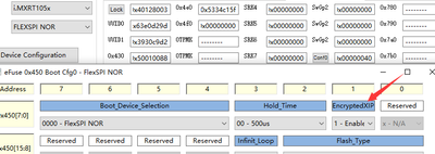

You need to enable below EncryptedXIP bit - BOOT_CFG1[1].

the XIP  have been seeting in efuse. please help double check.

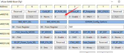

Please check BT_FUSE_SEL bit, refer to 1.2.2 and 1.2.3 sections in https://www.cnblogs.com/henjay724/p/9034563.html

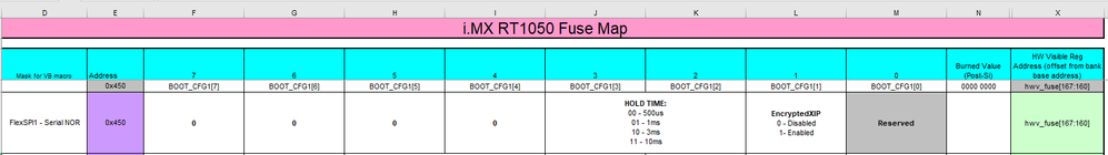

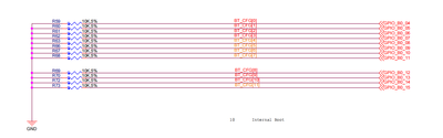

serial NOR flash have been mounte on the PCBA, and below  is my setting:
1. internal boot mode,(0010)
2. BT_fuse_SEL=0 in fuse
3. The detail info of Boot_CFG pin is below PIC.(Due to the board can not power on. I have tried to change the"BT_CFG[1]" to High and enbale the XIP. At last, the board still can not power on .)
Till now, my board is ok in "Dev usigned image boot "mode, and fail in "encrypted imaged boot" mode.
the boot CFG seeting if related this case?
