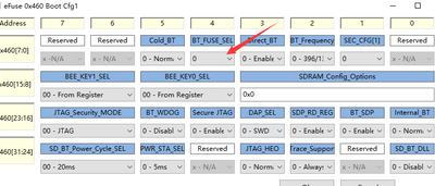

Gavin-liu
Sorry for my post.
the XIP  have been seeting in efuse. please help double check.
thank you in advance!
4,686 Views
jay_heng
Please check BT_FUSE_SEL bit, refer to 1.2.2 and 1.2.3 sections in https://www.cnblogs.com/henjay724/p/9034563.html

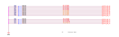

serial NOR flash have been mounte on the PCBA, and below  is my setting:
1. internal boot mode,(0010)
2. BT_fuse_SEL=0 in fuse
3. The detail info of Boot_CFG pin is below PIC.(Due to the board can not power on. I have tried to change the"BT_CFG[1]" to High and enbale the XIP. At last, the board still can not power on .)
Till now, my board is ok in "Dev usigned image boot "mode, and fail in "encrypted imaged boot" mode.
the boot CFG seeting if related this case?

jay_heng
You can do some tests to verify it is app issue or BootROM issue
Below two blogs may help you:
https://www.cnblogs.com/henjay724/p/14446183.html
https://www.cnblogs.com/henjay724/p/14479276.html
