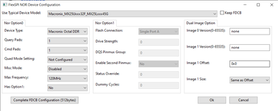

I found this issue was caused by I used different QSPI flash, how can I config for different size NOR flash to avoid this issue?

We use Macronix MX25L25645GZ2I-08G instead of ISSI IS25WP064AJBLE for test.
1. MX25L25645GZ2I-08G NOR Flash size is different with ISSI IS25WP064AJBLE, how could I config flash size in ota bootloader and lwip_httpssrv_ota_enet application?
2. Is there any other configs I need to modify for different NOR flash?

Regarding your questions, I think you may load your image file through the MCU Boot Utility by configuring the NOR flash size that you are going to use.
You may go to the correspondent tab and select your Micronix Flash and configure it before loading the image:
Hope this helps you, please let me know if you have more questions or doubts about it.
