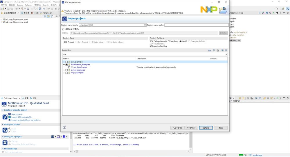

Step1. Install MCUXpresso IDE v11.6.0 and SDK 2.10.1
Step2. Import SDK examples "lwip_httpssrv_ota_enet" and named it  "v1_lwip_httpssrv_ota_enet" and "v2_lwip_httpssrv_ota_enet"
Step3. Modify the print message to identify the different image.
v1_lwip_httpssrv_ota_enet:
v2_lwip_httpssrv_ota_enet:
Step4. Release build the "v1_lwip_httpssrv_ota_enet" and "v2_lwip_httpssrv_ota_enet" project
Step 5. Create the binary file of "v1_lwip_httpssrv_ota_enet" and "v2_lwip_httpssrv_ota_enet"
Step 6. Import SDK examples "ota_bootloader", release build and create binary file.

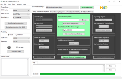

Regarding your questions, I think you may load your image file through the MCU Boot Utility by configuring the NOR flash size that you are going to use.
You may go to the correspondent tab and select your Micronix Flash and configure it before loading the image:
Hope this helps you, please let me know if you have more questions or doubts about it.
