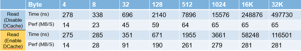

When enable DCache, the HyperRAM performance increased to 281MB/s, that shows the bottleneck is not at FlexSPI controller itself. The RT system design affect the performance, which is quite complicated. We can optimize the system configuration and enhance the system integrated performance.

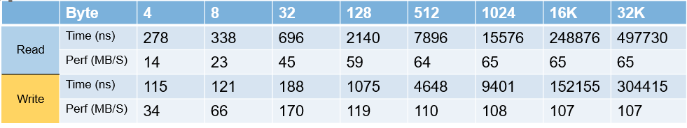

And please check below test performance about i.MXRT1050 works with HyperRAM ([email protected]):
Enabling cache to improve Hyper RAM performance more:
Test 1: Disable Cache (HyperRAM MPU config: non-shareable; Cacheable; Write back; Disable Dcache)
Test 2:  Enable Cache (HyperRAM MPU config: non-shareable; Cacheable; Write back; Enable Dcache)

I pulled the information you provided and it is clear that the HyperRAM is supported. In my original description I mentioned that we would be moving a 90KB data block every 4msec. This is just moving the data, I then have to process it and be ready for the next block. The data in this block will be continually changing so it is unlikely that the caching will help that much (or maybe my understanding of caching is not so good). That being said I looked at the performance charts and am having trouble understanding why the performance is so slow. The parts themselves are rated at 333MB/sec at 1.8V, if I give up 50% of this performance it is still well above the 65MB/sec (uncached) in your table. Is this a limitation within the flex spi controller in the RT MCU? If it is then this is not a viable solution to my problem.

I read the entire  document you provided AN12239 and towards the end I read the paragraph below, particularily the line I have highlighted in red. This does explain how the Dcache could have such an impact, I now understand and feel this is viable for my future goal.
"Even with the FlexSPI read prefetch enabled, the read access performance is not as good as it could be. The key reason is the invalidation of the internal AHB read burst. The disabled Dcache will limit the AHB read access in the single mode. When the Dcache is enabled, the AHB read access can be implemented in the INCR burst mode and the performance improves, as shown in Table 5 and Figure 16."
