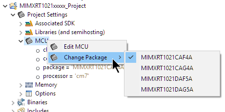

Change the package in the project settings:
I hope this helps,
Erich
