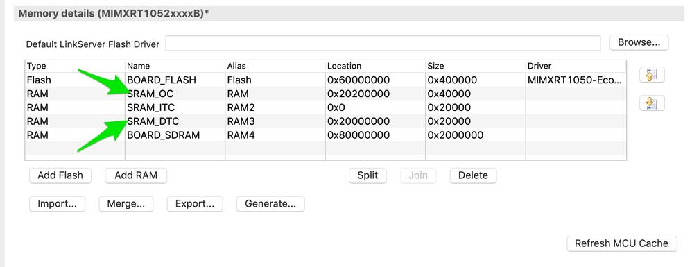

This can be tested using the sdk example "sdcard_fatfs_freertos" and switching the memory config to use SRAM_OC as "RAM" region instead of the default of SRAM_DTC.

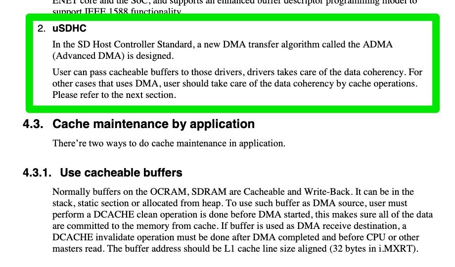

Looking at AN12042   it specifically states that usdhc uses ADMA which takes care of cache coherency, so I'm not sure why the example doesn't run without change from OCRAM.

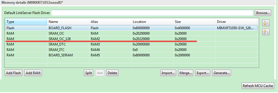

1. Partitioning a RAM block from OCRAM for non-cacheable buffers used by sdcard driver like the Fig1 shows.
Fig 1

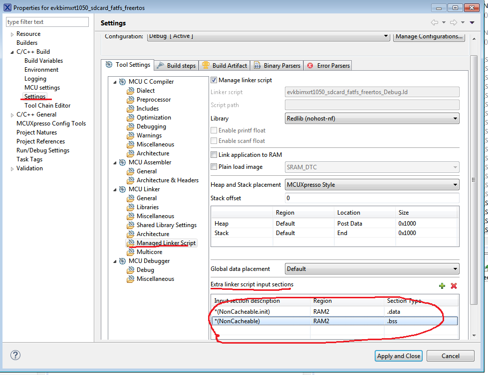

3. Add an extra link section to put the noncaheable variables into the memory you created.
Fig 2

All  you need to do is choose the SDK example for "sdcard_fatfs_freertos" and then switch the memory regions so that SRAM_OC is used as the "RAM" alias.

In AN12042, the 4.3.1 Use cacheable buffers section shows the way of use cacheable buffers in the OCRAM, please give a try by using cache functions in the fsl_cache.c.

In AN12042 it states (for uSDHC) that cacheable buffers can be passed to the driver:

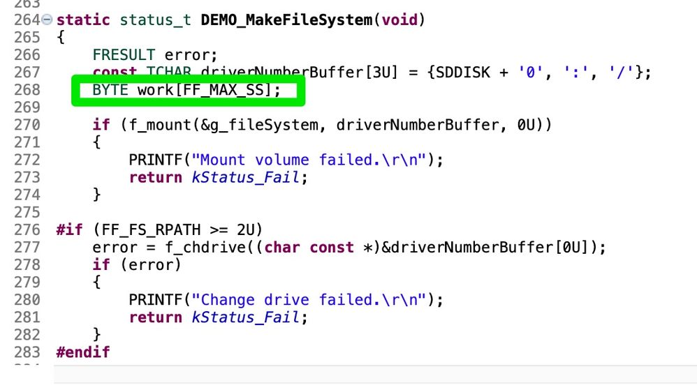

The SDK example uses a generic byte buffer:
workspace_-_evkbimxrt1050_sdcard_fatfs_freertos_test_OCRAM_source_sdcard_fatfs_freertos_c_-_MCUXpresso_IDE.jpg

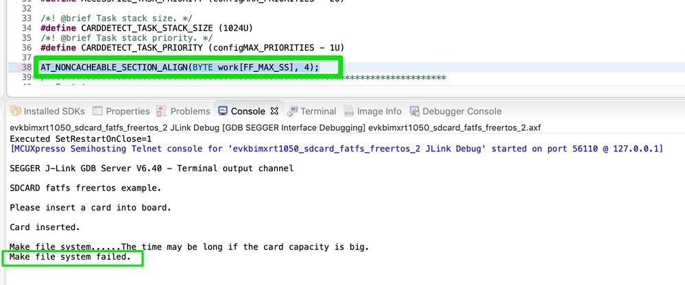

I also tried changing this buffer to be non-cacheable, without success:
workspace_-_evkbimxrt1050_sdcard_fatfs_freertos_2_source_sdcard_fatfs_freertos_c_-_MCUXpresso_IDE.jpg
