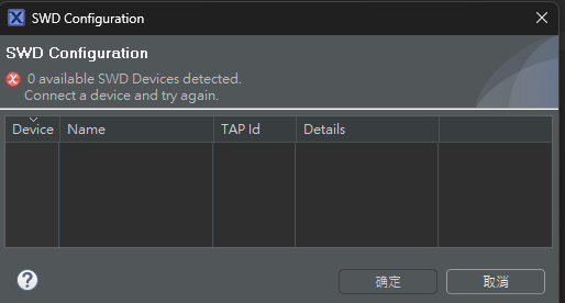

I haven't touched the RT1064 development board for three days. Everything was working perfectly three days ago, but after powering it back on from J41 today, I encountered the following problem:  it seems the IDE can detect the CMSIS-DAP on the board, but during SWD scanning, it shows that the target core cannot be found and displays a Wire Ack Fault, unable to connect to the chip's debug port.
I have checked the USB connection, unplugged and plugged it in again, and restarted the IDE, but the problem persists. LED D3 is lit, and after the error occurred, LED D20 remains lit red.
How can I resolve this issue?
Thank you for helping me
Tomy
Executing flash operation 'Program' (Program file into flash: Debug\evkmimxrt1064_lwip_dhcp_freertos_RT1064_MicroOCPP.axf) - Tue Mar 17 19:42:17 CST 2026
Checking MCU info...
Scanning for targets...
Executing flash action...
MCUXpresso IDE RedlinkMulti Driver v24.9 (Sep 19 2024 19:34:05 - crt_emu_cm_redlink.exe build 802)
( 0) Reading remote configuration
Wc(03). No cache support.
Found chip XML file in C:/nxp/Workspaces/RT1064/evkmimxrt1064_lwip_dhcp_freertos_RT1064_MicroOCPP/Debug\MIMXRT1064xxxxA.xml
( 5) Remote configuration complete
Reconnected to existing LinkServer process.
Connecting to probe 1 core 0 (using server started externally) reports:
'Ee(42). Could not connect to core.'
Retrying...
Server OK but no connection to probe 1 core 0 (after 3 attempts) - Ee(42). Could not connect to core.
============= SCRIPT: RT1064_connect.scp =============
RT1064 Connect Script
DpID = 0BD11477
Error: Wire Ack Fault - target connected?
Disabling MPU
Configure FlexRAM for 768KB OC RAM, 128KB I-TCM, 128KB D-TCM
Finished
============= END SCRIPT =============================
Failed on connect: Ee(42). Could not connect to core.
No connection to chip's debug port
(100) Target Operation Failed
Unable to perform operation!
Command failed with exit code 1

Hi @Tomy61410,
Please try recovering the debug access to your RT by following the steps described on this post: RT board recovery for debugger connect issues. Let me know if the issue persists.
BR,
Edwin.

Tomy61410
Thank you so much
