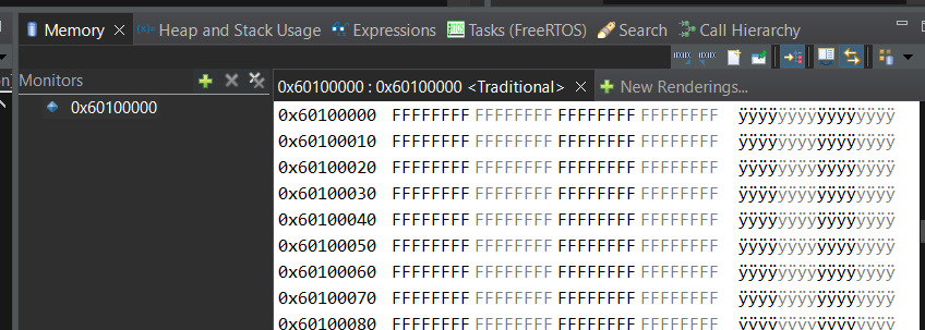

Hello NXP Community,
I'm encountering an issue while trying to load an application to MCUboot during the debug process. Here are the steps I've taken and the problems I'm facing:
Steps Taken:
Post-Build Script:
I created a post-build script that signs the application.
Loading the Signed .bin File:
  • Initially, I attempted to load the signed .bin file using the GDB command load in the Debug configuration/Startup.
  • I tried placing the command in both the Initialization and Run command sections with the following syntax:
load path/file_signed.elf 0x60...​
To perform this task, I followed these articles:
Problems Encountered:
  • The code appears to be completely ignored. After starting the debug session, I checked the flash, and it was blank.
  • I'm not sure if there are issues with the GDB commands or the conversion process.
Alternative Method Tried:
  • I also tried using LinkServer, which worked, but I don't know how to run the script when I start the debug session.
  • I need the probe to remain unused and for the probe to be taken by GDB when I start the debug session. For the probe, I'm using an MCU-link.
Request for Assistance:
  • Could anyone provide guidance or any suggestions on correctly loading the signed .bin file using GDB during the debug process?
Thank you for your help!

MassimilianoPegaso
Hi @Gavin_Jia,
I use an MCU-link as a debugger interface. To manually load the signed application, I use a command like this:
LinkServer.exe flash MIMXRT1052xxxxB:IMXRT1050_Refill load C:\application_signed.bin --addr 0x60100000
I need to specify the flash command because I need to load this application onto a custom board that uses a different flash memory than the EVK board.
It work, the problem is that I don't know how to run this code automatically in the IDE. I tried a solution like this:
But it doesn't work; it seems that the command is completely ignored. I don't know how to check if the command reports an error when it is executed.
I tried various combinations of the command: I placed it in the initialization command section, in the run command section, and I tried the GDB version (like load data.bin.elf 0x70000). I attempted it with and without flash in front of it or on the previous line. Nothing changed; the load is never performed.
As a completion, the initialization command section included this command:
set non-stop on
set pagination off
set mi-async
set remotetimeout 60000
##target_extended_remote##
set mem inaccessible-by-default ${mem.access}
mon ondisconnect ${ondisconnect}
set arm force-mode thumb
${load}
Best regards.

Gavin_Jia
Hi @MassimilianoPegaso ,
Thanks for your update.
I tried your procedure with similar results. Also, I tried adding scripts, and if there are errors in the commands in the scripts, the IDE points them out when running Debug and the operation is interrupted:
So I think the commands in the script were actually executed successfully, except that in a subsequent operation, the IDE emptied the previous signed.bin file again. If you're just trying to burn it into flash and the command line succeeds, I don't think we actually need to stick to the IDE point-and-click-and-succeed approach.
It's perfectly fine to try writing scripts or executing it via the post-build command after compiling, after all, this operation doesn't require the IDE's debugging capabilities.
