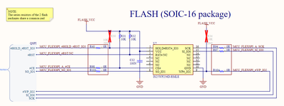

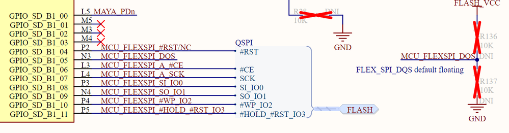

Hi all,
I have a custom design that resembles the the MIMXRT1060-EVK. I am using the same flash chip (IS25WP064-ABLE) as the EVK, and I have connected it as on the EVK (see bellow)
I can connect to the MCU through SWD and through Serial Download mode. I can erase/read/write the Flash (0x60000000 address space). The issue that I have is that the code does not run and I cannot debug.
What could I do to troubleshoot this? Should it work like that, or am I missing something?
Thank you in advance!

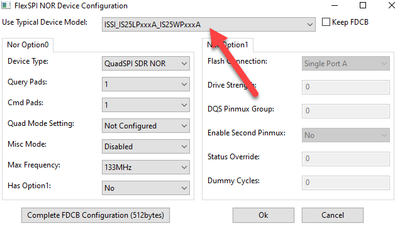

2) I have a secondary flash footprint for a bigger flash (ISSI IS25WP256D-RMLE) that I could also use. Could you help me on how I should configure things for it to work?
-- Actually, the NXP-MCUBootUtility tool can program an image to IS25WP256D-RMLE, which is as same as the IS25WP064, when selecting the below device option.

Hi @jeremyzhou
The circuit for the SOIC-16 Flash is the following:
The thing is that I have 2 boards from preproduction, one with the ISSI IS25WP256D-RMLE (the Flash that I am planning to use for production) and one with ISSI IS25WP256D-JMLE (that I soldered just for tests).
- Board with IS25WP256D-JMLE is programmable and debuggable through SWD with J-LINK
- Board with IS25WP256D-RMLE is programmable but not debuggable through SWD with J-LINK.
Other than the 2 Flash chips the 2 boards should be identical.
My questions are:
1. Do I have to change something (in code or in PCB) for the RESET pin on the -RMLE flash?
2. What is the mechanism that makes it programmable but not debuggable?
Also I have tried to solder the ISSI IS25WP256D-RMLE on the EVK in the past but I could not get it to debug either (but to be honest I thought it was not working due to bad signal integrity of the lines with the rework). The ISSI IS25WP256D-RMLE is SOIC-16 and the EVK uses an ISSI IS25WP064A-JBLE which is SOIC-8, so the rework was with airwires and a SOIC-16 breakout.
Thank you in advance for your valuable help so far!

jeremyzhou
Thanks for your reply and clarification.
-- No, I don't think so.
-- I guess the issue is related to the Flashloader algorithm, you can refer to solution to update the default Flashloader algorithm of Jlink.
