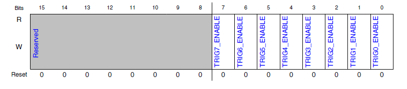

for every trigger of the ADC-ETC it is possible to enable DMA
DMA_CTRL register of ADC-ETC peripheral:
but Table 3-3. DMA MUX Mapping of RT1020 Reference Manual shows only one DMA Request signal for ADC_ETC
Is it possible to use a different DMA Transfer configuration for every ADC-ETC trigger source?

1) Is it possible to use a different DMA Transfer configuration for every ADC-ETC trigger source?
-- No, I'm afraid it's impossible.
