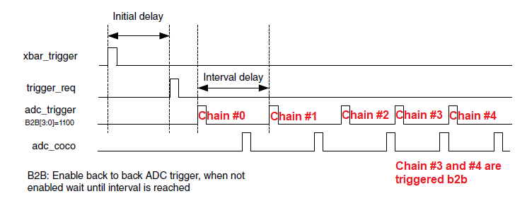

I have already posted some questions regarding ADC and ADC_ETC in this post but have got no answer so far. Now I have another question.
The RT1020 Reference Manual provides this diagram where I added some information for my question below.

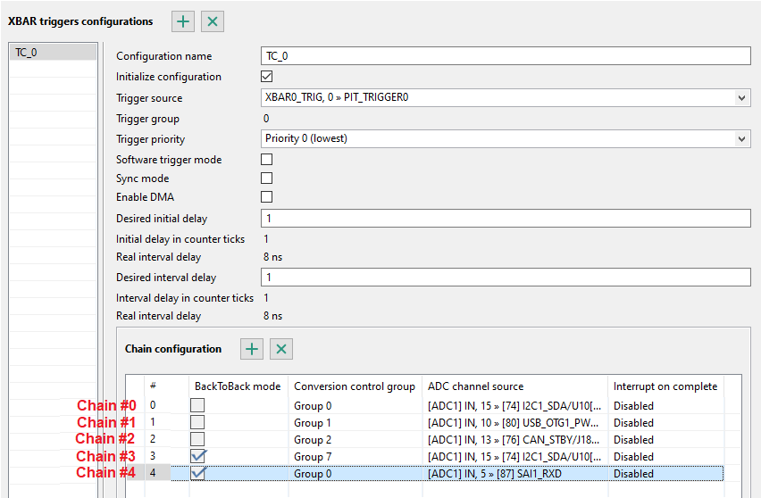

I think the above timing diagram would equal to these settings in MCUXpresso Config Tools:
Question 1:
Are my following thoughts regarding the signals correct?
  • The xbar_trigger comes from the peripheral I chose (PIT_TRIGGER0)
  • The xbar_trigger will be internally delayed in the ADC_ETC peripheral and after the Initial delay it will generate an internal signal trigger_req.
  • Some other part of the peripheral will receive the trigger_req signal and send the adc_trigger signal to the ADC peripheral. Each pulse on the adc_trigger signal corresponds to one ADC_ETC chain entry for the selected trigger. Therefore after the initial delay the first trigger pulse will start the conversion of chain element #0, the second pulse will start conversion for chain element #1 and so on. Chain elements #3 and #4 will be triggered back2back.
Question 2:
Is it correct that Chain element #3 has b2b enabled which means "If chain #2 finished the conversion start conversion of chain #3 as soon as possible"?
Question 3:
Is it correct that the b2b field of Chain #0 has no effect because it is the first chain # which will be triggered and it only waits for the initial delay?
Question 4:
The Conversion control group can be selected for every chain element. The conversion control group specifies which control register for hardware triggers and which result register (ADCx_HCn & ADCx_Rn) will be used for the conversion.
If I set up my chain element #0 and chain element #4 to use the Conversion control group 0, will the conversion result of chain #4 overwrite the conversion result of chain #0?

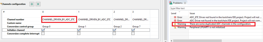

Do I have to set up the Conversion control groups in the ADC peripheral driver with MCUXpresso Config Tools like this
(every Conversion control group with Channel number set to CHANNEL_DRIVEN_BY_ADC_ETC) or will it be enough to initialize the ADC_ETC and the ADC channels will be initialized by the ADC_ETC peripheral?
If I set up the channels like shown above it will result in the warning that there are some duplicated ADC channels in the configuration > the warning suggests that I am doing something wrong here.

Hi Stefan Mitterhauser
1) Yes.
2) Yes.
3) Yes.
4) No, the Data in the ADCx_R0 register will be overwritten, but the data for chain elements #0 and #4 will be stored in TRIG0_RESULT_1_0 DATA0 and TRIG0_RESULT_5_4 DATA4 registers.
5) It needs to set up the conversion control groups in the ADC peripheral driver in the MCUXpresso Config Tools.
