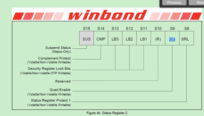

2.When you test the SDK code:
SDK_2_10_1_MIMXRT1170-EVK\boards\evkmimxrt1170\driver_examples\flexspi\nor\polling_transfer
Please modify the LUT table, as your QSPI is not the same as the EVK board, QE bit position also not the same, so I think your Quad mode is not enabled until now in your customer board.

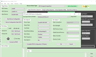

4. Internal boot mode 10 is not working. In EVK we cannot flash through serial downloader when switch is in 10 position, but in custom board we can flash successfully in 10 mode also
Answer: you can also use the serial download mode 01
Then use the MCUBOOTUTILITY to connect and program your board:
https://github.com/JayHeng/NXP-MCUBootUtility/archive/refs/tags/v3.4.0.zip
the related user manual is:
Please also try it, whether your connection, program works.

   Yes, I know, when you do the successful operation in the EVK with W25Q512NWEIM , the flashloader may help you enable the QE, but your customer board still didn't work, and download is OK, so I suspect your QE is not enabled, as seems you didn't specially enable it. As you know, in the boot code, xip will use quad mode to read the code, if your QE bit is not set, the boot will have issues. And the QE bit is the non-volatile writeable bit, so to the new chip, you need to enable it at first.
  Two ways:
1. Use the SDK my mentioned code with the modification, download it to the RAM and run it, check the result, it also check your external QSPI works Ok or not with the flexSPI bus in the customer board.
2. Use my mentioned MCUBootUtility tool, download code in the serial download mode, with my pictures configuration.
Please test it on your side, in fact, it is easy to test.

  Don't test the internal boot mode, test the internal boot mode with MCUbootutility, whether you can do the connection, program, read memory?
   Please also check the JTAG_MOD pin, it should connect to GND through 10k resistor:
