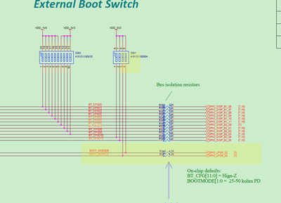

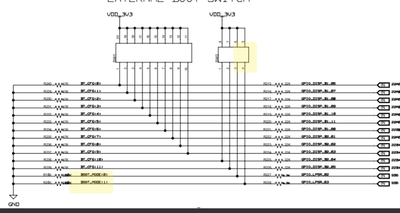

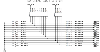

 Please check the boot mode:
You mentioned 10, whether it is BOOT_MODE[1:0]=10, as I find your pin 3 is Mode0, pin 4 is mode 1, it is not the same as the EVK board.
Please double check your customer board mode setting.
Kerry
5,555 次查看
ancymuhammed
We had seen this before. We tried the internal boot mode in 01 instead of 10. Then also it is not working. Probed the waveforms boot mode(0) & POR. All are seen same as EVK
