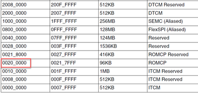

hi,
I'm recently working on iMXRT1050EVKB and i found out that address 00200000-00217fff is shown reserved in the file IMXRT1050 reference manual.
But, it's a memory space for ROMCP(bootrom i guess) in other materials i found on some tutorials.
So i got bit confused which one is right? and if the file is right, where should be it's ROM space?

Hi @MINGZ ,
In the early version of the RM, it illustrates the memory space for the ROM code, however, it's removed in the recent version to avoid confusing the customers.

Thanks a lot, BTW how does its exsitence become a confusion?
