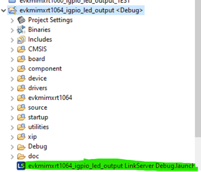

Hi Pavel, I am not exactly sure if this is what you are asking - I am unsure how the launcher is relevant as we need to use JLink Commander to program with the JLink probe, not MCUXpresso. JLink Commander/JLink is our production tool and so we need to be able to program with that toolset. Our code is also not built in MCUXpresso, so again I don't think the launcher is relevant.
In case this is what you are after, here is the output from a successful programming via MCUXpresso / LPCLink (i.e. the first time programming after which all subsequent programming work regardless of the method).
Executing flash operation 'Program' (Program file into flash: test_ads1119.elf) - Thu May 02 14:13:52 PDT 2024

Hello, maybe need to recover control, indicates the processor is still in some sort of debug mode could you try to do the steps on the thread?
RT board recovery for debugger connect issues - NXP Community
Does this mean you are working on a dual-core project?
Trying to follow the example from the connect m7 wake m4 and reset scp scripts, I am running the following commands in JLINK for the first execution:

Hello, could you test the led blinky led and share the LOG file and the popup image is this are showed.
In other observations did you erase the Launcher to switch the debugger flavor?
Pavel
