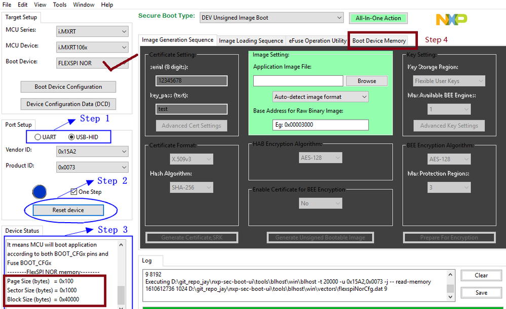

choonshyan_lim
Hi Stefan,
Thanks for sharing the post to erase the flash.  I tried out Serial Downloader + NXP-MCUBootUtility approach and it worked.
I share my steps in details for beginners like me.
Cheers,
Shyan
[MIMXRT1060 EVK] Erasing Boot Device Memory with Serial Downloader Mode and NXP-MCUBootUtility
1.Download NXP-MCUBootUtility from Github
         download zip - GitHub - JayHeng/NXP-MCUBootUtility
         unzip - unzip into your user directory
         exe - run NXP-MCUBootUtility.exe in bin later

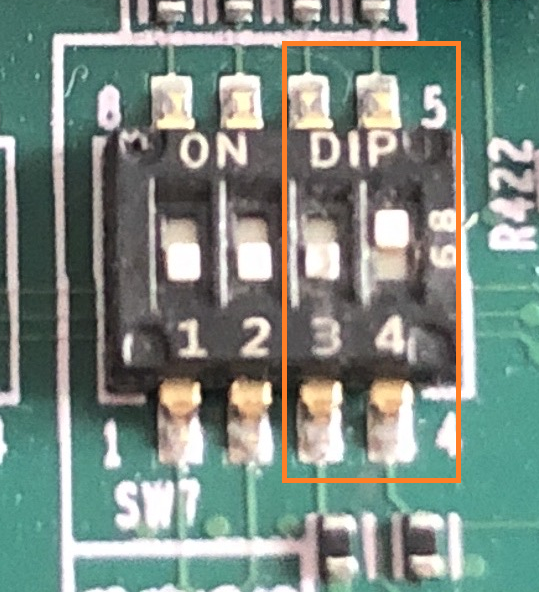

2. Configure EVB into Serial Downloader Mode
3. Connect PC USB cable to J9
4. Power up EVB
5. Run NXP-MCUBootUtility.exe
     Follow these steps provided by the guide in the Github,
      3.1 Setting the target device
     - use default NOR settings, do not need to configure anything
      3.2 Connecting target devices
      - In Device status, should see Memory information after successful connection to the ROM (Step 3 shown below)
      4.0 Advance Usage
      - set tool to run in Master Mode through the function menu bar Tools->Option
      4.4 Universal Flash Programmer
       - Go to "Boot Device Memory" Tab (Step 4 shown below)
       - Good to verify using read operation before erase or write
