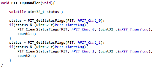

I am using I.MXRT1064.

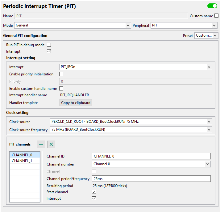

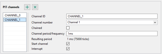

I have configured the PIT channel 0 for 25ms and Channel 1 for 1ms. Both in interrupt mode.
But interrupt triggers only for 25ms but not for 1ms.
Following are the screenshots of configuration.

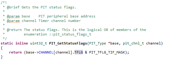

The interrupt routine is written as below,
Please let me know if anything is missing here.

Hi Victor,
The issue is resolved by manually deactivating the chain mode for Channel 1. Thank you very much.
This is required only when I am using channel 1. For Channel 2, this change is not required and everything works with auto-generated code.
Thanks both of you (Mark and Victor) for looking in to this issue and providing valuable inputs.

victorjimenez
Hello Vishal,
This behavior is due to the ERRATA ERR050130. As a workaround, I would suggest you use Channel 2 instead of Channel 1 of the PIT.
Link to the ERRATA.
Victor

victorjimenez
I made some tests on my side with the Evaluation Board. It seems that the Chain mode is activated by default on Channel 1 of the PIT. vishaldahiwal@gmail.com, If you want to use Channel 1, as a workaround, you will need to deactivate the chain mode manually before initializing the channel. For example, before calling the function   PIT_StartTimer(PIT_PERIPHERAL, PIT_CHANNEL_1); You will need to deactivate the chain mode, this can be done with the following instruction: PIT->CHANNEL[1].TCTRL &= ~PIT_TCTRL_CHN_MASK;
Victor
5,643 Views
vishaldahiwal
Hi Victor,
Vishal

Your interrupt handler is correct so it is probably an issue with the PIT configuration.
I just tested the following code that operated correctly (channel 0 interrupts ever 500us and channel 1 interrupts every 20ms)

The configuration seems similar. I tried it but did not work. As I am using the MCUXpresso, the code is auto generated.
I observed that the TFLG is not set for Channel 1. It sets for Channel 0.
The below code always returns 0 for channel 1.
Vishal
