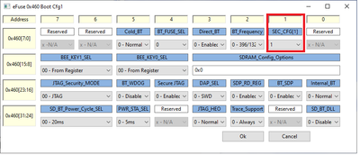

I'm working on custom board using MIMXRT1052CVL5B. I was config "SEC_CFG[1] = 1"  in "MCU Boot Utility v3.4.0" software via UART:

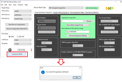

After i Save->Burn->Reboot my board, i cannot connect to "MCU Boot Utility" via UART. When i connect, this messeger show:
My question: "How to connect MCU Boot Utility to iMXRT105 via UART".

1) Can you help me to find "Serial (8 digits)" and "key_pass (text)" ?
-- Please check it under the NXP-MCUBootUtility-master\gen\hab_cert directory.
Plus, please select the HAB Signed Image Boot prior to clicking the Connect to ROM and you can give it a try.

jeremyzhou
Firstly, the HAB secure boot has already been enabled after burning the SEC_CFG[1], secondly, it needs to import keys for the MCUbootUtility tool, and last, it should select the HAB Signed Image Boot.

I readed MCU Boot Utility's manual, and finded instruction Enable HAB signature authentication:
However, i never set a keys for imxrt, therefore i don't know keys. Can you help me to find "Serial (8 digits)" and "key_pass (text)" ?
