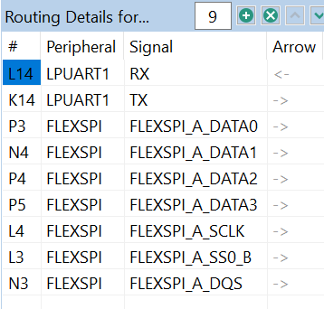

Can you help us find the "1bit SDR mode" configuration?
should I replace each occurrence of "kFLEXSPI_Command_SDR" with "kFLEXSPI_Command_MODE1_SDR" ???
and after that, how do we translate these :
into MISO MOSI CS CLK ?

The LUT table is described in section 27.5.7 in reference manual. After read this section you will know how to modify it according to your design.
In Single mode, flash transmit/receive data on 1 Data pin (DATA0 for transmitting, DATA1 for receiving).
