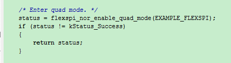

jeremyzhou
for the opportunity to serve you.
To enable the QE bit, we'd highly recommend the developer to debug the flexspi_nor_polling_transfe (~\SDK_2.6.1_EVKB-IMXRT1050\boards\evkbimxrt1050\driver_examples\flexspi\nor\polling_transfer) demo project once, the demo project provides the flexspi_nor_enable_quad_mode() function which can set the QE bit.
Please give a try.
TIC
2,943 Views
SpoonMan
Hi @jeremyzhou,
I noticed that the exact identical example for i.MX RT1060 is also invoking flexspi_nor_enable_quad_mode() method even if, according to @diego_charles reply to my thread:
https://community.nxp.com/t5/i-MX-RT/Cannot-understand-how-XIP-FlexSPI-configuration-could-work-on/m...
he said that BootROM is in charge to (magically?) set QE bit in status register before program execution starts. So the question is, what's the purpose of invoking this method? If I skip it, the example works flawlessly.
