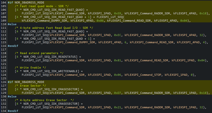

For what concerns eXecution In Place (XIP), I modified flexspi_nor_config_t structure as follows:

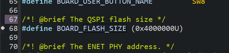

in particular I modified sflashA1Size to match my new 512Mb (64MB) flash size and I changed the first 32-bit word in commands LUT by substituting EBh command (24-bit addressing by default) with ECh command (32-bit addressing by default) and by specifing that 32-bits of address are following instead of 24-bits. After this, I also ensured BOARD_FLASH_SIZE in board.h matched my new flash size:

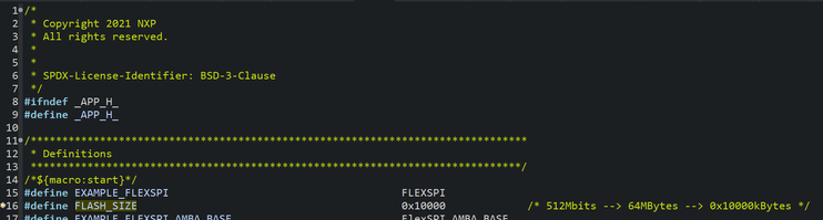

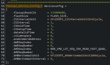

For what concerns the application (flexspi_nor_polling_transfer), I first adapted FLASH_SIZE definition in app.h to match my new flash size (notice that this macro will then be used to fill flashSize field in flexspi_device_config_t structure used in main.c to initialize FlexSPI peripheral, thus requiring flash size is in KBytes, not Bytes

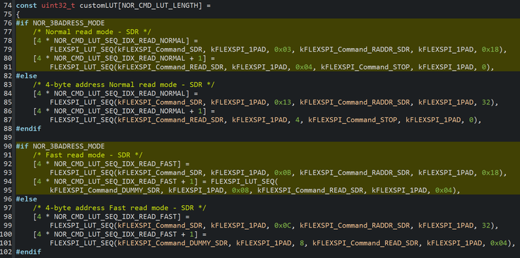

and last but not least, I modified all commands in customLUT to use the 32-bit addressing version of the command originally used by the demo example, e.g. I replaced 03h with 13h for Normal Read Single Data Rate, 0xD7 with 0x21 for Erase Sector, etc. and every time I also specified an ADDR length of 32 bits instead of 24:
