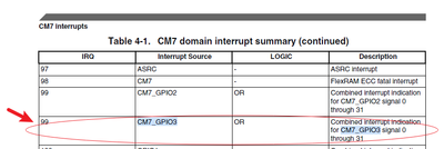

I am working on the i.MX RT1170.
In my project, I have some pins from GPIO9 configured as inputs.
However, in the SDK examples, I do not see a dedicated IRQ handler for GPIO9 (like GPIO9_Combined_x_y_IRQHandler).
I want to enable interrupts for these GPIO9 input pins, but I am not sure:
  1. Which IRQ number/handler should I use for GPIO9 in the i.MX RT1170?
  2. If GPIO9 does not have its own IRQ, is it combined with another port's IRQ?

Hi @sanjana291 ,
Regarding your question "Which IRQ number/handler should I use for GPIO9 in the i.MX RT1170? " and  "If GPIO9 does not have its own IRQ, is it combined with another port's IRQ?"
In RT1170 chip, GPIO9 can use  interrupt number 99.
Wish it helps you.
Wish you a nice day!
Best Regards
MayLiu
434 次查看
sanjana291
I'm asking about GPIO9, can we use GPIO3's IRQ for this instead? but GPIO9 has an IRQ on the CM4
