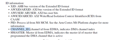

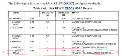

I am configuring the XRDC2 to block the eDMA from making transfers to a specific memory region. I manage to do that by doing this :
    xrdc2_master_domain_assignment_t assignment;
    XRDC2_GetDefaultMasterDomainAssignment(&assignment);
    /* Defining privileges to the eDMA */
    assignment.lock          = false;
    assignment.privilegeAttr = kXRDC2_ForcePrivilege;
    assignment.secureAttr    = kXRDC2_ForceNonSecure;
    assignment.domainId      = 3;
    /* Forcing to apply the policy to all eDMA transactions */
    assignment.mask = 0xFFFFFFFFU;
    assignment.match = 0x00000000U;
    XRDC2_SetMasterDomainAssignment(DEMO_XRDC2, kXRDC2_Master_M7_EDMA, 0,        &assignment);
The problem is that by setting MASK = 0xFFFFFFFFU and MATCH = 0x00000000U a hit is generated for all the eDMA transfers.
I would like to know how I can fine tune the MASK/MATCH fields.
Thanks !

Hi @mneroda ,
Thanks for your updated information.
I check the IMXRT1170RM, I find the following table.
Wish it helps you.
Best Regards
MayLiu
Wish it helps you.
Best Regards
MayLiu
