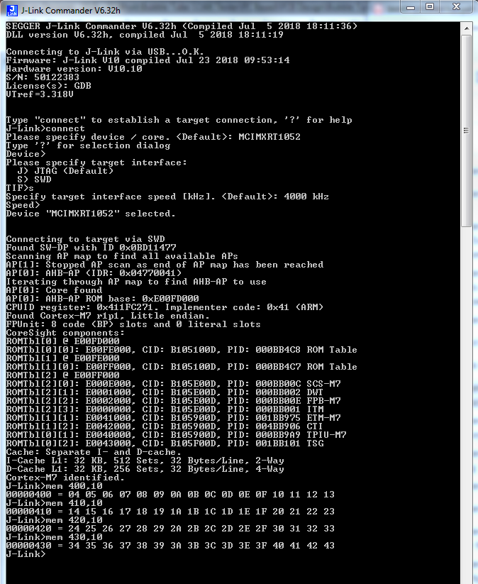

I’m using a J-Link to program a NXP MCIMXRT1052 chip, and need to program/blow some of its eFuse registers.
However, I've troubles even reading the eFuse registers, let along writing them, in J-Link Commander.
According to Table 5-9 in the MCIMXRT1052 datasheet, register at 0x420 should contain Unique ID of the chip. However, when I do a "mem 420,10" command in J-Link Commander, to read the content at the 0x420 address, it just returns a bunch of neatly count-up numbers, just like all other eFuse registers, which can't be right. (Please have a look at the attached screanshot below)
Have I just typed in a wrong address? or where else could have gone wrong?
Cheers
Larry

Hi Larry
one can try example from below link and implement it with jlink:
How to burn BT_FUSE_SEL on RT1050
