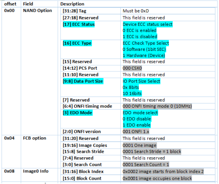

I got an update from NXP about the Flashloader SEMC SLC NAND configuration.  This is not yet available in existing reference manual.  They said they'll be having an application note about SEMC SLC NAND Boot soon.  Below is the option configuration description when initializing parallel NAND flash via SEMC.

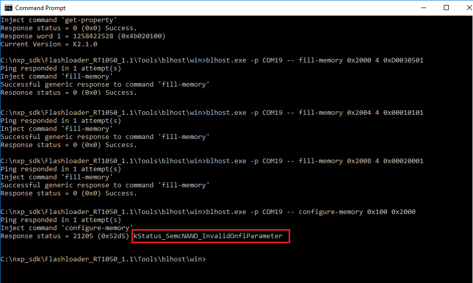

I know that it has a different boot control block structure and I've read that section in the reference manual.
The question is on the flashloader usage when enabling the parallel NAND flash SEMC.  When I run the these commands (this is equivalent to the series of commands in my original post) in blhost as shown below, I'm getting this error, "kStatus_SemcNAND_InvalidOnfiParameter".
This has something to do with the option values (0xD0030501, 0x00010101, 0x00020001) passed to the "--configure-memory" with memId = 0x100 (SLC raw NAND over SEMC module).  This option values are not documented in the MCUX FlashLoader RM.  This manual only describes the configuration option block values for FlexSPI NOR.

TC58BVG1S3HTA00 is not ONFI-compliant NAND device, so Flashloader cannot support this device, you need to modifiy Flashloader, you can refer this thread https://community.nxp.com/thread/489622
