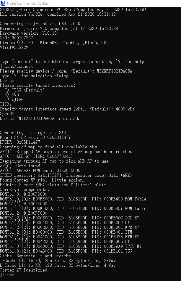

    MIMXRT1020 can use the JLINK connect the chip with SWD interface directly, you don't need to modify the fuse. If you leave the SWD interface, just use your debugger to connect it.
   As it is your own customer board, at first, you can use the JLINK command to connect the RT chip at first, whether it can find the ARM core or not, when you can find the ARM core, the hardware is OK to connect, if you can't find the ARM core, it means your hardware still have issues.
   This is the JLINK command connect result with JLINK and SWD interface to RT1020:

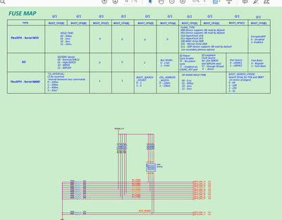

So, please help to check your hardware, do you leave your BOOT_MODE[0,1] pin, and BOOT_CFG pin?  And the UART interface or the USB interface
If you do not leave, you can't select the boot mode with the pin.
Please help to confirm your schematic at first.
KERRY
7,497 次查看
VolcanicCheese
Our custom board boots from boot from fuses mode. By default, the MCU starts up with serial downloader when there are no fuses programmed. We need to burn the fuse to start the MCU with internal boot mode so that we could boot it up with the external flash. The Boot_CFG pin is the same as the default configuration on the dev board. I tried both USB and uart to see what works. I was not able to connect with it with the dev board with the SW8 configured to be boot from fuses mode. I was wondering how could we burn the fuses by using a JLINK connector? I would like if you could show me step by step guide on how I could burn the fuses to set it up to internal boot mode using a JLINK connector? Thank you!

Also, I had no trouble connecting the dev board and custom board using the JLINK commander. For now, it does not seem like an issue with the custom board when I get the same results with the dev board. Thanks!

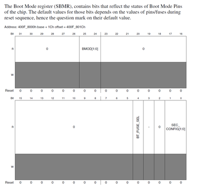

I tried flashing and debugging the board with the SDK project.
I set up the fuse map address and write the value as shown below for the example project to burn the eFuse to set up the boot mode to internal boot mode.
I figured out the fuse map address and fuse write value based on this page on the reference manual.
Flashing the program do not do anything because it seems the project works on runtime.
Question: Where do I setup the fuse map address and write value to burn the fuse with serial downloader mode using a Jlink Connector with the OCOTP example SDK project?

Answer: No, I was not able to debug it step by step and I was not sure how to ensure that the code gets download to the internal RAM. When I run the code,  It gets stuck at the boot ROM as mentioned on the post that I linked.
Question: Your mentioned your fuse didn't work previously, please tell me which detail area you modified? And the readout value, then I will help you to check the position.
Answer: Sorry if this does not make any sense, what I am saying. I am new to this and trying to figure this out. I am using the Boot Mode Register Address and trying to write a bit to BT_FUSE_SEL.
I was not sure where in the example SDK project I am supposed to write the fuse map address and write value. Looking at the example SDK project. It seems like I need to write the values here as shown in the screenshot below:
But is this not for the shadow register? I thought the shadow register works by allowing you to see what happens if you do burn the eFuse without burning the eFuse.
