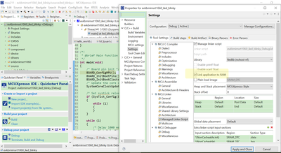

1. Run code in RAM in the MCUXPresso IDE
Answer: Please use the following configuration:
Select the Link application to RAM, then your code will run in debug mode, even you work in serial download mode, I have tested it, and confirm serial download mode, the RAM debug is OK.

   You need to download the code to the internal RAM in the serial download mode, can you debug it step by step?
   If yes, then you can follow the fusemap and the OCOTP register do the read, write, and read, whether that works on your side?
   Your mentioned your fuse didn't work previously, please tell me which detail area you modified? And the readout value, then I will help you to check the position.
   If you can debug step by step, you even can check the register directly.
   Now, what's the IDE you are using?

Answer: No, I was not able to debug it step by step and I was not sure how to ensure that the code gets download to the internal RAM. When I run the code,  It gets stuck at the boot ROM as mentioned on the post that I linked.

kerryzhou
Hi @VolcanicCheese
2. I was not sure where in the example SDK project I am supposed to write the fuse map address and write value
Answer: You are right, EXAMPLE_OCOTP_SHADOW_REGISTER_READ_WRITE_ENABLE is used to control the write code, as you know, fuse is one time operation, it just can be modify from 0 to 1, and can't write back. So, to the SDK code, it is very careful, and don't want the customer write the fuse directly, so it just give a fuse read version.
When customer need to write the fuse, customer can set
#define EXAMPLE_OCOTP_SHADOW_REGISTER_READ_WRITE_ENABLE 1U.
You also need to double check the fuse address, which is the correct address area.
To be honesty, to the new user, normally, I don't recommend customer operate the fuse, but your customer board situation is special, you didn't leave the GPIO for the BOOT_CFG.
Wish it helps you!
