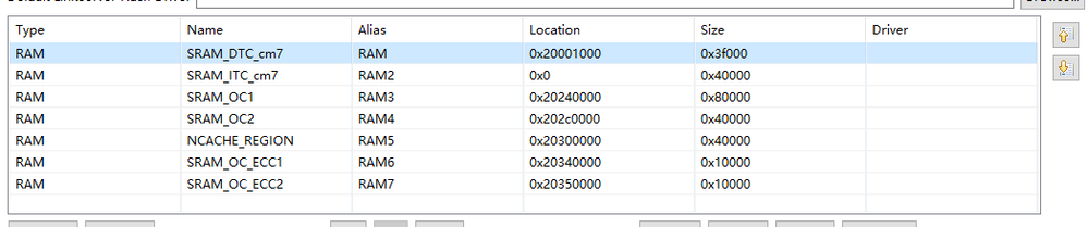

check "Link application to RAM"
(3)MCU settings is as below

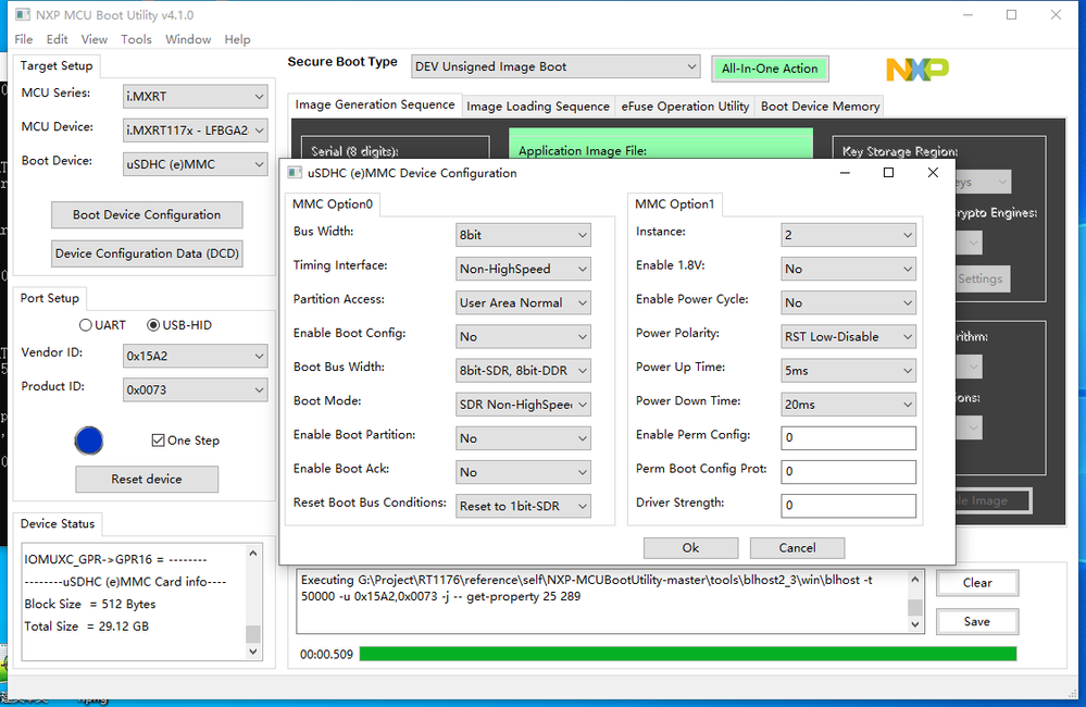

3.MCUBootUtility
(1)Config as below and connect through USB successfully

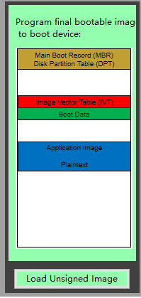

(2)Generate Unsigned Bootable Image
(3)Load Unsigned Image
Then I reboot the system,the program doesn't run.How can I boot from EMMC?
I've checked the binary do have been written to EMMC successfully through MCUBootUtility.
