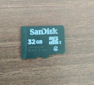

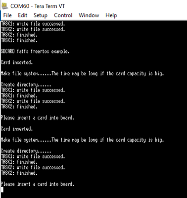

 I think, it may related to your used class 4 SD card, as my side, all are class 4 sd card:

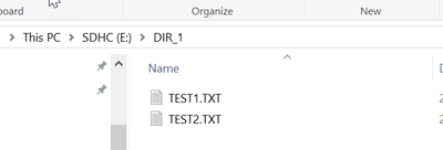

You also need to do the FAT32 format at first:

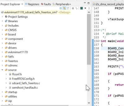

Then I run the SDK2.15.0 for RT1170-EVK board:

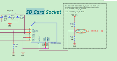

If you use the NXP MIMXRT1170-EVK board, you also need to solder R136.
This is my test result:
You can see, my class 4 SD card is working OK.
Maybe you also can find one sandisk micro sdhc class 4 to test it.
Wish it helps you!

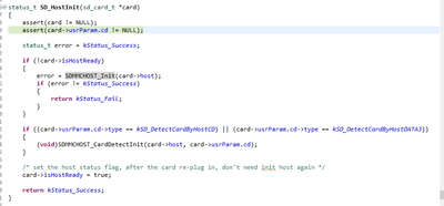

I am using an RT 1170 custom board. There is no card detect pin.

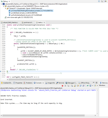

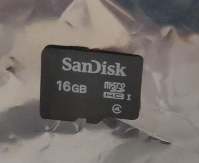

I have tried with two SD cards (formatted as FAT32 as you mentioned), but the process gets stuck in the function mentioned below.
Stuck in function SD_SendInterfaceCondition as mentioned below
However, it is working fine with the Samsung Class 6 SD card.

When you test the NXP board, please connect the card detection pin resistor

Since we don't have the RT 1170 EVK board, I am sharing the schematics of our custom board.
Do any software changes need to be made because our connector dont have the card detection feature?
When I created a custom project, it didn't get stuck, but it is showing an assert error like this:
ASSERT ERROR " card->usrParam.cd != NULL ": file "fsl_sd.c" Line "2129" function name "SD_HostInit"
Am I missing any settings?

kerryzhou
Hi @akhil__
  You can comment the data, and the card detect data, then test it again, whether you can pass it or not?
  As I also use sandisc class 4, it works on my side, I have a lot of class 4 SD card, that works OK.
