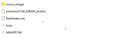

The flashloader.srec which is given in SPT tool as
nxp\MCUX_Provi_v4.1\bin\data\targets\MIMXRT1166
I would like to know how can i get flashloader.srec as SPT got?
is there any procedure to follow?
kindly suggest me

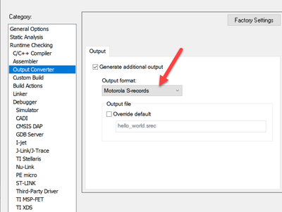

I built flash loader example from SDK 2.12 and got flashloader.bin
I want to know how to convert from flashloader.bin to flashloader.srec , because I need to convert elf to flash loader bootable image, for that I need to give flashloader.srec as input.
Do you follow certain steps or any tool to convert flashloader.bin to flashloader.srec?
Thanks & Regards,
Balajikrishnan.G.S
6,161件の閲覧回数
jeremyzhou
Hi @gsbalajikrishnan ,
Thanks for your reply.
1) Do you follow certain steps or any tool to convert flashloader.bin to flashloader.srec?
-- The IDEs can generate the srec file when compiling completes, for example, the IAR provides the setting to generate the srec file, and you can refer to the corresponding IDE's guide to learn how to generate this kind of file.
