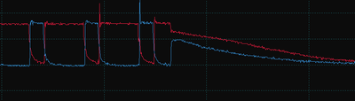

PseudoCircuit
Setting the OUTEN bit to 0 results in both PWM A and PWM B being active and gradually dropping off, which is very undesirable:
Using PWM faults does drop both outputs properly to 0. I'm trying to set up QTMR to count the PWM cycles as you described and then trigger the PWM fault. However, the quad timer does not seem to work, is there an example of using Quad Timer as a counter with external input? Here is my initialization code, maybe you can spot what is wrong with it.

xiangjun_rong
Regarding the gradually dropping off issue, I suppose that PWM_xA and PWM_xB are in tri-state after you clear the OUTEN bits, pls connect an external  pull-down resistor on the PWM_xA and PWM_xB pins, I think the dropping-off phenomenon will disappear.  I think you can enable the pin on-chip pull-down resistor by configuring the IOMUXC_SW_PAD_CTL_PAD_GPIO_xxxx to have a test.
