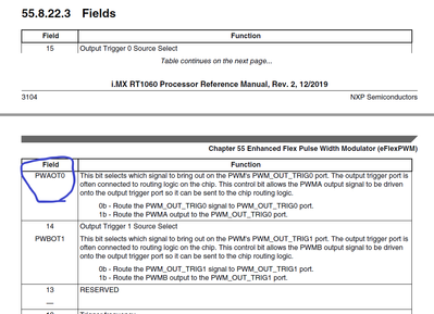

For the QuadTimer issue that you can not get interrupt for the quadTimer3_TMR0, I think you have to set the bit 8 of IOMUXC_GPR_GPR6 so that the input quadTimer3_TMR0 is from the XBAR.
Hope it can help you
XiangJun Rong
4,313 Views
PseudoCircuit
You're right, I needed to set the IOMUXC bit to select XBARA as input for QTMR. I did not need to change anything with the PWMAOT0 bit. However, this was not the only issue I had to fix. For future reference: I also needed to set TMR_CTRL_ONCE and TMR_CTRL_LENGTH bits to 1 and TMR_CTRL_OUTMODE to 2 (set on compare). To perform this PWM cycle counting and fault triggering operation multiple times, I also had to set TMR_SCTRL_VAL as 0 and write 1 to TMR_SCTRL_FORCE to reset the OFLAG (which is connected to the PWM fault) back to 0 before starting the timer again.
4,347 Views
xiangjun_rong
I suppose that you have to set either PWMAOT0 bit or PWMBOT1 bit od the EflexPWM_SM3.
