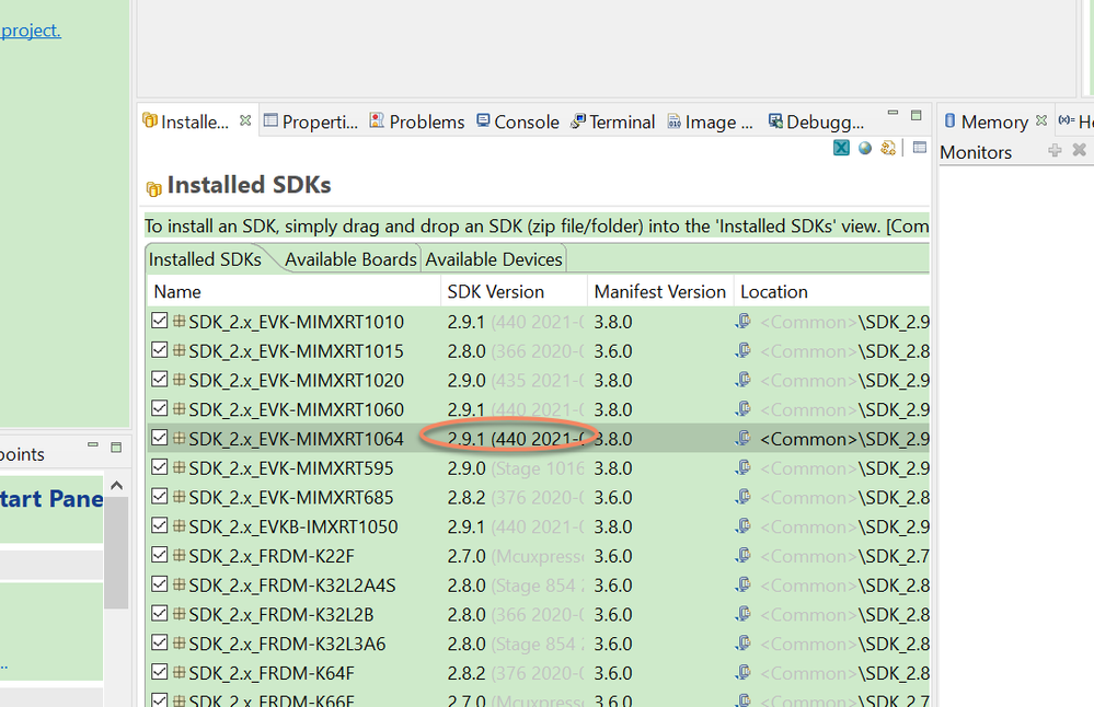

kerryzhou
Hi K314X,
 Which detail User Guider you are referring now? From the SDK?
 Which SDK version you are using? I need to check more details.
  You also can give me some pictures of your questions, it will help me to understand your questions.
  This one?
\SDK_2.9.1_EVK-MIMXRT1064\boards\evkmimxrt1064\littlevgl_examples\littlevgl_guider
I can see the littlevgl_guider , so do you download the newest SDK?
Please use the newest SDK and test it again.
Kerry

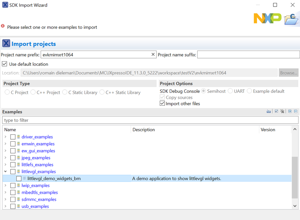

K314X
I am referring to the User Guide from the Gui Guider "Help" tab.
User guideUser guide
I am using the latest SDK for the 1064, with the right package (LVGL  Open Source Graphics Library), also tried with all packages just to make sure I wouldnt miss something.
SDK package/middlewareSDK package/middleware
Latest SDKLatest SDK
I import it to MCUXpresso IDE, use the "import example from SDK" option, but cannot find "littlevgl_guider"
no gui guider exampleno gui guider example
I will attach the User Guide pdf.

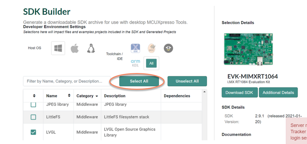

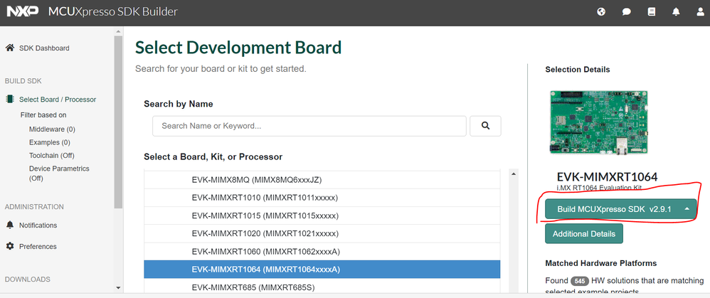

kerryzhou
Hi K314X,
  Please don't worry, and follow me to try it again.
  1. Download the SDK area
     Select All, and generate the code and download it again:
2. Do you drag your newest SDK package to the installed SDK?
if you do all these, you should like me can find the related guider project.
Please try it again.
If you still have issues, please kindly let me know.
kerry

K314X
The issue was that I did not select enough packs I believe, I had LVGS, FREERTOS and others selected but did not want all of them since some seemed to me not relevant for what i wanted to do.
I did have the latest versions and followed the right procedure to install the sdk but could not find the gui guider proejct. When I use "select all" then it is now available.
I guess it doesn't change much if i select all or not even if i don't need them all. I am unsure which ones are the necessary ones though to have the project available but this is not important.

kerryzhou
Hi K314X,
  Next time, when you download the SDK, you can select the middleware as all, then that SDK will contains the complete the projects.
Wish it helps you!
Kerry

K314X
Hi, thanks for answering.
So like I said I tried multiple projects. I tried the Printer Demo, Animing Demo and making GUIs from the emptyDemo option all with the right board template for the MIMXR1064. From Gui Guider you can run on target and it works. Now I followed the User Gude and exported the generated code. I downloaded the right SDK Code with the LVGS package, imported it to MCUXpresso IDE then created a new project the way it is shown in the User Guide (import SDK example). However i do not have the littlevgl_guider option in th littlevgl_examples folder (step 4 . F). But I took one of the other ones to give a try and created the project. But now i am lost with what was generated ^^. Where can i modify the code to change the behavior of a button for example, like change its background color, without having to go back to the Gui Guider tool ?
I am confused about that workflow by the way. Do i really need to export the code from Gui Guider whenever I do a modification and then modify manually the "custom", "generated", and "source/lv_conf.h" folders of the MCUXpresso  IDE project by the one generated by the Gui Guider tool ? Is there a way to have this automatically done ?
