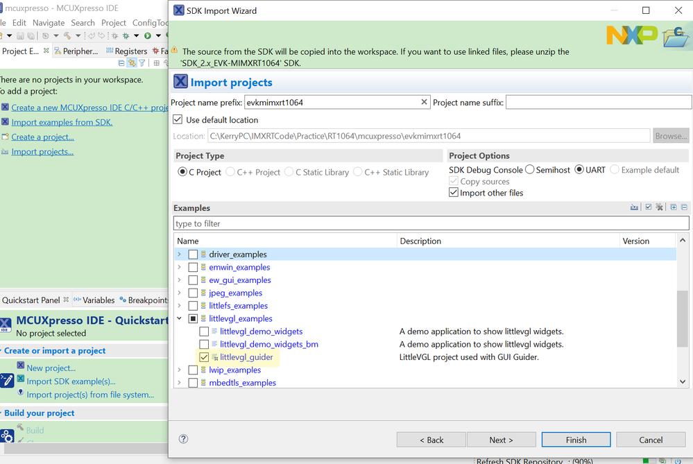

I am discovering how to work with the new Gui Guider tool and I am a bit confused by the workflow. So I started a project from scratch with the application template for the MIMXRT1064-EVK board (with a rk043fn02h Rocketch display). I am able to run on target my project but I am trying to understand how to modify through user code the UI. I do not understand what and where to look at... Are there any official documentation appart from the User Guide ? How do i work with the generated project in the MCUXpressoIDE ?

  This one?
\SDK_2.9.1_EVK-MIMXRT1064\boards\evkmimxrt1064\littlevgl_examples\littlevgl_guider
I can see the littlevgl_guider , so do you download the newest SDK?
Please use the newest SDK and test it again.
Kerry

I import it to MCUXpresso IDE, use the "import example from SDK" option, but cannot find "littlevgl_guider"

  Please don't worry, and follow me to try it again.
  1. Download the SDK area
     Select All, and generate the code and download it again:
2. Do you drag your newest SDK package to the installed SDK?
if you do all these, you should like me can find the related guider project.
Please try it again.

K314X
The issue was that I did not select enough packs I believe, I had LVGS, FREERTOS and others selected but did not want all of them since some seemed to me not relevant for what i wanted to do.
I did have the latest versions and followed the right procedure to install the sdk but could not find the gui guider proejct. When I use "select all" then it is now available.
I guess it doesn't change much if i select all or not even if i don't need them all. I am unsure which ones are the necessary ones though to have the project available but this is not important.
