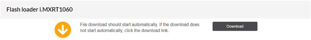

we're working with i.MX RT1060 EVK board and we're wondering about best practices for In-Application Programming.
We can correctly use Sdphost and Blhost utility, according to: Flash loader i.MXRT1060https://cache.nxp.com/secured/assets/downloads/en/programmers/FLASHLOADER-RT106x-1-GA.zip?__gda__=15...
However, we can not use boot pin mode for hardware's constraints.
