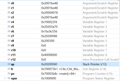

when I observe stack usage ita overflowing even before entering main.
i have another question, why do we modify  fsl_flexspi_nor_boot.c, I saw map file before and after, reset is at same location
also when I execute code I am seeing cases where variable values are getting overwritten as if stack is overrunning into data section

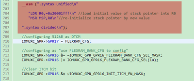

Thanks for providing the example code. I apologize, I forgot to mention that you need to place the stack at the beginning of the DTC. To do this you need to add the following code right before you start reallocating the FlexRAM.

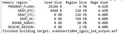

I've never seen this behavior before. The code that you are using looks fine. Did you modify the MPU as well? Why is your heap size is set to 0? When you compile your project, how does the memory usage looks? You can see this in the console after you build your application as shown below.
Regarding the changes on the fsl_flexspi_nor_boot.c. You are not changing the address of the reset handler, you are just changing the entry address of the application. As I mentioned in the document, there are lots of dangerous areas in reconfiguring the FlexRAM in code. It pretty much all boils down to the fact that any code/data/stack information written to the RAM can end up changing location during the reallocation. This change is to avoid that any problems with these things.
Victor

I have heap zero as am not planning to use any dynamic allocation.
following is the usage as shown in the console
regarding MPU, yes I did changes to it too, am not using external SDRAM or flash connected at 0x60000000 so I disabled those sections.

victorjimenez
Thanks for your patience with this case. Yes, I was able to replicate the behavior that you mentioned. I investigated this internally and found out what was causing it. As I mentioned in the community document, there are lots of dangerous areas in reconfiguring the FlexRAM in code. It pretty much all boils down to the fact that any code/data/stack information written to the RAM can end up changing location during the reallocation. You've happened upon the other danger with pointing the stack into RAM locations that are moving. To overcome this you'll need to place the stack at the start of the DTCM memory and change the size. I will add this information to the community document.
Victor

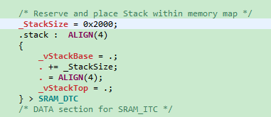

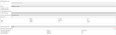

In the linker file, you will need to modify the stack as shown below.
Once you do this, you shouldn't have any problems.
As mentioned in the community document, all these changes are needed because you are reallocating the FlexRAM through software. When you reallocate it using the fuses, these changes in the linker file and the stack won't be needed.
Victor
11,444件の閲覧回数
sandeepa2
Sorry if I am missing the point, wont the linker file get automatically generated if we select "manage linker file" checkbox in project settings?
anycase, when I opened like file stack setting is showing exactly like how it is depicted by you.
/* Reserve and place Stack within memory map */
_StackSize = 0x2000;
.stack : ALIGN(4)
_vStackBase = .;
. += _StackSize;
. = ALIGN(4);
_vStackTop = .;
} > SRAM_DTC

victorjimenez
Victor
9,534件の閲覧回数
alan-p
Hello Victor,
Can you explain how you came up with 0x20001FFF as the value for the stack pointer location? I tried to match the linker settings in your community write up, and the stack got located at 0x20001000. The default code in ResetISR already contains code for initializing the SP:
__asm volatile ("MSR MSP, %0" : : "r" (&_vStackTop) : );
The line above would set SP to 0x20001000 rather than 0x20001FFF. Why should the SP be set differently when FlexRAM is configured dynamically (rather than from fuses)?
