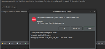

I am using i.MX RT1176 and MCU xPRESSO IDE.I am running the code in OCRAM. This structure works with the bootloader. But I have problems when I want to debug the app code without the bootloader.
How can i fix this?

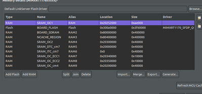

Memory settings:
**Link app to ram actived.

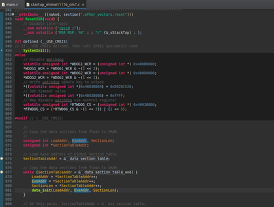

In the ResetHandler(), I encounter this problem after entering the while loop written for the copying process from flash to SRAM.
1,088件の閲覧回数
Habib_MS
@SpeedyGonzalesss,
Sorry for my misunderstanding but I cannot see the issue in this image, can you provide me more information about this issue?
