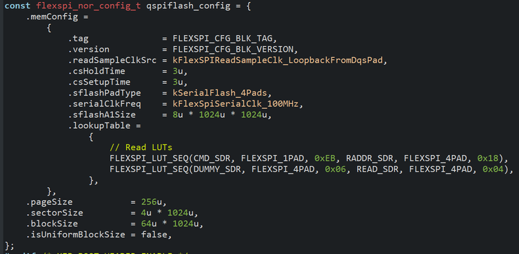

I can't truly understand how the configuration coming with XIP examples on IMXRT1060-EVKB could work with IS25WP064 QSPI Flash memory.
Provided configuration is the following:
from where it's clear that LUT command setup here at index 0, corresponding to the read command according to Table 22-2 in Reference Manual, is 0xEB which corresponds to Fast Read Quad I/O Operation from IS25WP064 datasheet while there's no evidence about if, where and how QE (Quad-Enable) bit is set in status register to enable the use of such quad-read operation.

I sadly have to say you're still not answering to my question... Please, check the screenshot in heading post, you can see by your eyes that XIP read command in LUT is configured as:
FLEXSPI_LUT_SEQ(CMD_SDR, FLEXSPI_1PAD, 0xEB, RADDR_SDR, FLEXSPI_4PAD, 0x18),
FLEXSPI_LUT_SEQ(DUMMY_SDR, FLEXSPI_4PAD, 0x06, READ_SDR, FLEXSPI_4PAD, 0x04),

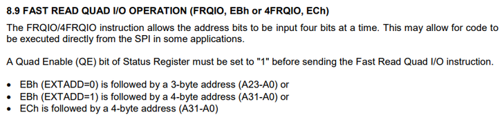

which means that FAST READ QUAD I/O command is configured to send address, dummy cycles and read data on 4 lines, and according to IS25WP512M Flash memory datasheet:
QE bit in Status Register must be set before sending such instruction.
So, the question is... how is this possible? Who, when and where is sending Write Status Register command with appropriate QE bit set?

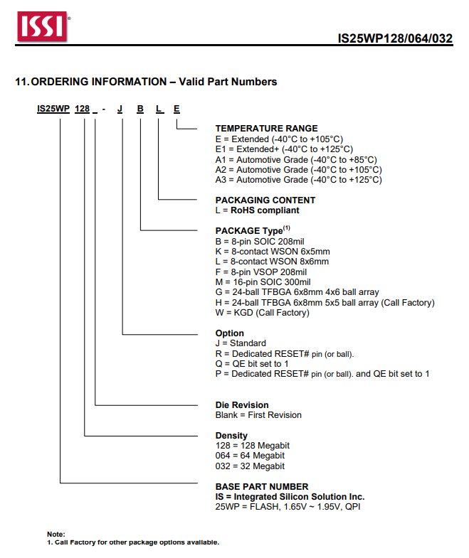

P.S. Yes, I know IS25WP512M is not the standard Flash mounted on eval board, but IS25WP064AJBLE should be the same because J means "standard" and not "QE=1 by factory" according the datasheet:
