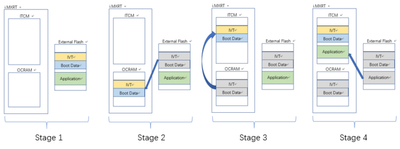

According to your proposal, you want to RT1060 boot from the QSPI flash in NON-XIP mode which consists of the below steps (as the below figure shows).
1) Bootable image is in the external flash.
2) loads the starting 4 KB of data from the bootable image to the internal SRAM (OCRAM). It includes the IVT and BD information and will be used for the application image loading.
3) BootROM transfers the starting 4 KB of data from the internal SRAM (OCRAM) to the destination address space of the bootable image.
4) BootROM continues loading the rest of the bootable image from the external flash to the destination address space and starts up the application binary.
To generate a bootable image to implement the above mode, please refer to the post to do it.
