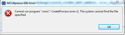

I work with MIMXRT1160-EVK.
First I build a project.
Then I start Debug  and this message pops-up first
Then I get

What should I do?
