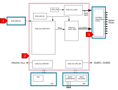

The Clock Controller Module(CCM) facilitates the clock generation in the RT platforms, many clocking variations are possible and the maximum clock frequency for the i.MX RT1060 device is @600MHz.The following image shows a block diagram of the CCM, the three marked sub-modules are important to understand all the clock path from the clock generation(oscillators or crystals) to the clock management for all the peripherals of the board.
javier_chavezq_19-1599155717168.pngjavier_chavezq_19-1599155717168.png Figure 1. Clock Controller Module(CCM) Block Diagram
  1.        CCM Analog Submodule
This submodule contains all the oscillators and several PLL’s that provide a clock source to the principal CMM module.

  1.        Clock Control Module(CCM)
The Clock Control Module (CCM) generates and controls clocks to the various modules in the design and manages low power modes. This module uses the available clock sources(PLL reference clocks and PFDs) to generate the clock roots. There are two important sub-blocks inside the CCM listed below.
  • Clock Switcher
This sub-block provides the registers that control which PLLs and PFDs outputs are selected as the reference clock for the Clock Root Generator.
  •  Clock Root Generator
This sub-block provides the registers that control most of the secondary clock source programming, including both the primary clock source selection and the clock dividers. The clock roots are each individual clocks to the core, system buses, and all other SoC peripherals, among those, are serial clocks, baud clocks, and special function blocks. All of these clock references are delivered to the Low Power Clock Gating unit(LPCG).
  1.        Low Power Clock Gating unit(LPCG)
The LPCG block receives the root clocks from CCM and splits them to clock branches for each peripheral. The clock branches are individually gated clocks.
The following image shows a detailed block diagram of the CMM with the previously described submodules and how they link together.

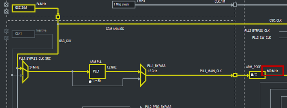

The Clock tools available in MCUXpresso IDE, allows you to understand and configure the clock source for the peripherals in the platform. The following diagram shows the default PLL1 mode configured @600MHz, the yellow path shows all the internal modules involved in the clock configuration.
javier_chavezq_21-1599155717575.pngjavier_chavezq_21-1599155717575.png Figure 3. Default PLL configuration after reset.
From the previous image notice that PLL1 is attached from the 24MHz oscillator, then the PLL1 is configured with a pre-scaler of 50 to achieve a frequency @1.2GHz, finally, a frequency divider by 2 let a final frequency @600MHz.

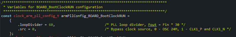

   1.2 Export clock configuration to the project
After you complete the clock configuration, the Clock Tool will update the source code in clock_config.c and clock_config.h, including all the clock functional groups that we created with the tool. This will include the clock source for specific peripherals.
In the previous example, we configured the PLL1 (ARM PLL) to a functional frequency @360MHz; this is translated to the following structure in source code: “armPllConfig_BOARD_BootClockRUN” and it’s used by “CLOCK_InitArmPll();” inside the “BOARD_BootClockPLL150MRUN();” function.
 Figure 5. PLL1 configuration struct

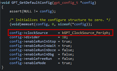

Using the available SDK example project “evkmimxrt1060_gpt_timer” a configuration struct for the peripheral “gptConfig” is called from the main initialization function inside the gpt_timer.c source file, the default configuration function with the configuration struct as a parameter, is shown in the following figure.
javier_chavezq_26-1599155718155.pngjavier_chavezq_26-1599155718155.pngFigure 8. Function that returns a GPT default configuration parameters
The function loads several parameters to the configuration struct(gptConfig), one of the fields is the Clock Source configuration, modifying this field will let us select an appropriate clock source for our application, the following figure shows the default configuration parameters inside the “GPT_GetDefaultConfig();” function.
 Figure 9. Configuration struct
In the default GPT configuration struct, the Peripheral Clock(kGPT_CLockSource_Periph) is selected, the SDK comes with several macros located at “fsl_gpt.h” header file, that helps to select an appropriate clock source. The next figure shows an enumerated type of data that contains the possible clock sources for the GPT.

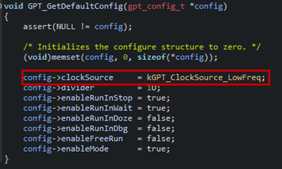

For example, to select the Low-Frequency Reference Clock the source code looks like the following figure.
 Figure 11. Low-Frequency Reference Clock attached to GPT

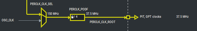

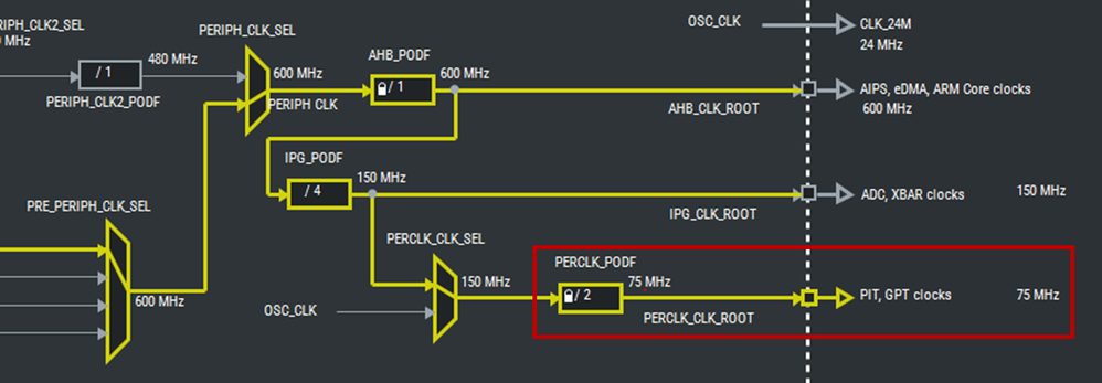

1.2 Modify the Peripheral Clock frequency from Clock Tools
One of the GPT clock sources is the “Peripheral Clock Source” this clock line can be modified from the Clock Tools, the following figure shows the default frequency configuration from Clock Tools view.javier_chavezq_31-1599155720592.pngjavier_chavezq_31-1599155720592.png
Figure 12. GPT Clock Root inside CMM
In the previous figure, the GPT clock line is @75MHz, notice that this is sourced from the primary peripheral clock line that is @600MHz attached to the ARM core clocks.
For example, modify the PERCLK_PODF divider selecting it and changing the divider value to 4, the resulting frequency is @37.5Mhz, the following figure illustrates these changes.
 Figure 13. GPT & PIT clock line @37.5MHz
In the previous example, we configured the GPT clock root divider by a dividing factor of 4 to achieve a 37.5MHz frequency; this is translated to the following instruction in source code: “CLOCK_SetDiv(kCLOCK_PerclkDiv,3);” inside the “BOARD_BootClockRUN();” function.
