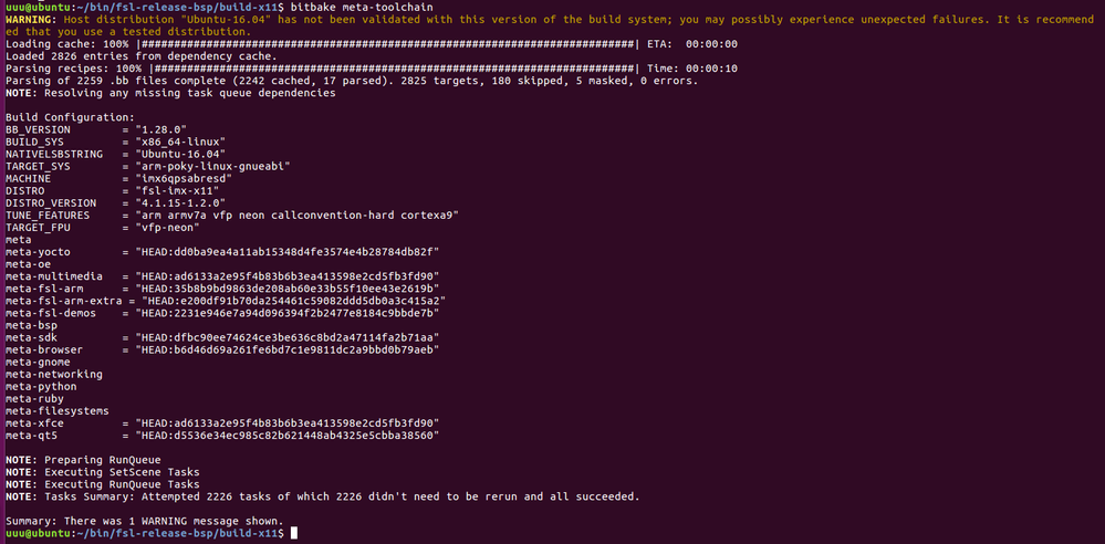

Dear Community
i meet problems installing the meta-toolchain in my computer.the system suggested that i successfully installed the toolchain
but when i use the toolchain it just said that the headers are not inculded
then i found the header directory is ignored because of "nonexistent" but thet do exist in my computer and is exactly the same name as the directory which is ignored.
can you help me solve the problem?

well, I solved it by using $CC to do the compile

nope, I don't think it solved the problem, it may because the headers is not linked to the tool chain.
I want to know how to link it to the toolchain.
or every time i have to use the script to run the toolchain.and the other headers may be also missing.
