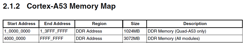

igorpadykov
Hi PK
according to sect.2.1.2 Cortex-A53 Memory Map i.MX8MDQ Reference Manual
max. ddr size is 3GB for "DDR Memory (All modules)"
https://www.nxp.com/docs/en/reference-manual/IMX8MDQLQRM.pdf
igor
7,164件の閲覧回数
PKZ
Hi igor,
Thanks for your reply. I have cheked that. But, it is also mentioned that for A-53Q, there is additional 1GB address space.
Doesn't it mean that max DDR for A-53Q is 4GB?
But there is no details/not documented in the BSP docs where and how we can specify this in code/device tree such that only A-53 uses the addition 1GB memory and all other modules access only the 3GB.
PK
